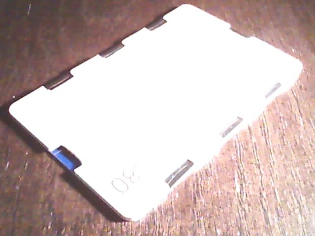

    Here's a crazy idea...just take another "extra" credit card and glue it to the back. Most credit card holders in wallets are designed for multiple cards anyway. For that matter you could use three cards(front, middle, and back) but then again you are back to the bulky aspect which spurred on this discussion.
    0
    RichardDawkins
    RichardDawkins
    Reply 12 years ago on Introduction
    That is exactly what I've done with the holder I made. You need 3 plastic credit-type cards. The one in the middle has memory card slots cut out of it. Measure for size, then score a line at the bottom of the slot. Using sissors, cut "into" the card to the score line. Bend the tab you've cut to open up the score and it snaps neatly off. Trim for size and you have your slot. Superglue that to another card will form the back.
    The final card needs little notches cut out before gluing to allow you to slide the cards out. That's it! I use mine to hold 8 micro-sd cards and I'm very pleased with the result.
    Caveat: Use too much superglue and you could glue your card into the slot. Tip: If you find the cards are too loose a fit in a slot, you can put a little kink in the side by pressing down from the top on the empty slot. This tightens up the hole and the cards don't fall out. Enjoy! :-)
