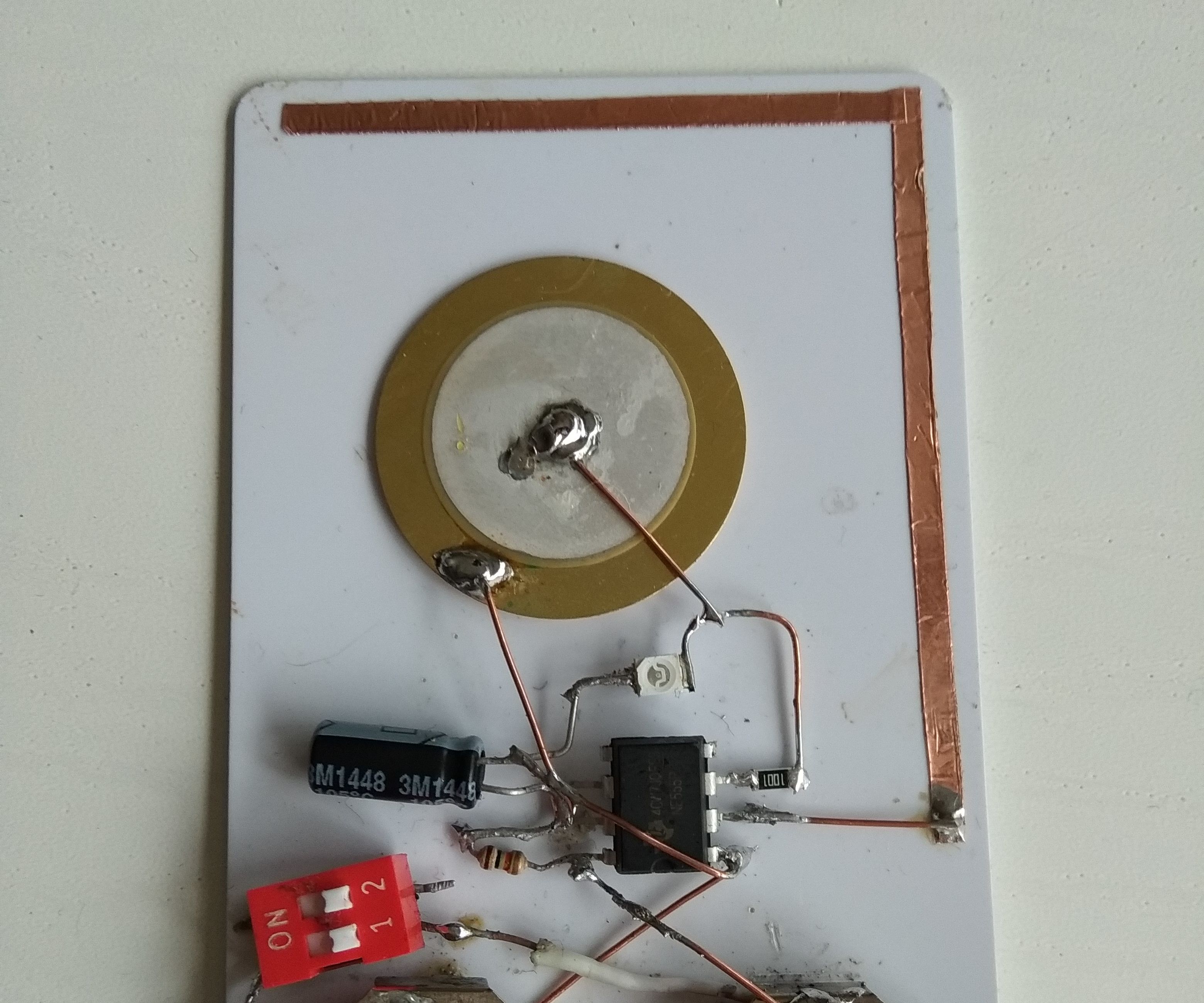

Hello everyone I want to show you my last project, a Credit Card Sized Metal Detector.
This is a Pocket and flat version of the original instructable:
Step 1: Previous Versions
I was happy with a previous version that I build, it was working very well, but the huge coil was giving it a Ghostbuster look. so I started wondering how to shrink it.
First I tried with a smaller coil, it worked better and was more compact, but I was still not happy.
So I went for the flat version and the coil was the biggest challenge.
I have tried several configurations, at the end I recycled a coil from a phone splitter.

Step 3: The Code and Circuit
As I said this project is a modification of the following original instructable:
Step 4: Final Version
As you can see, it is very fast and with good sensitivity.
