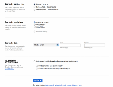

- Finally, Flickr. I know, duh! right? Lemme explain..... Flickr's got this really awesome 'Advanced Search' functionality that lets you choose what you're looking for, and what it can be used for. Plus they're usually great quality images, lots of variety, and at multiple resolutions. Great tool. Check the image.
- The best option really is to use a photo you've taken, if possible, but the above are always useful in any project.
