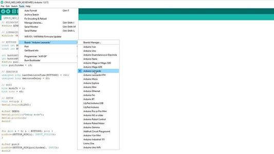

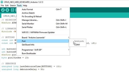

Step 3: Upload the Code
I used Arduino IDE to write and upload the code to the Arduino Mega
I used the MIDIUSB.h library to send the Midi messages to the DAW Software which you can add to the Arduino IDE from the "Manage Libraries" option at the Tools tab.
After installing the MIDIUSB library we have to choose from the menu Tools the model of Arduino that we use and the Port we have connected the Arduino.
Now we can click Upload and upload the code.
