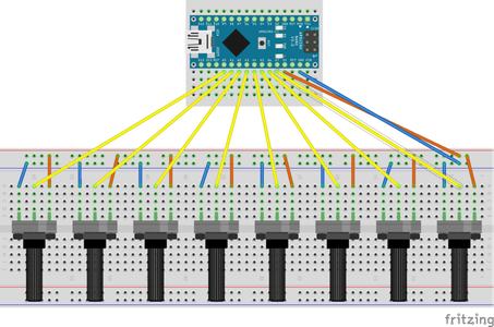

Step 1: Cricuit Assembly
We want to make a simple circuit with 8 potentiometers
- So we have to connect the left pin of each potentiometer with the GND Pin (Ground / Ground) of the Arduino
- the right pin with the 5Volt pin of the Arduino
- the middle pin of each potentiometer with an Analog Input of the Arduino. (The Arduino via Analog Inputs will read the value of each potentiometer to send the value to the parameter we have assigned it.)

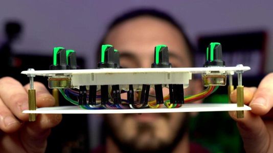

Step 3: Build a Case
At the time I built this project I didn't own a 3D Printer that would give me a lot of ease to the building proccess so I choosed to go with 2 pieces of plastc covers for electric boxes.
Construction Steps:
- I used a Solder Iron to open 8 holes for the potentiometers
- and 4 holes for the metal stand-offs
- I placed the Power and Ground pieces of the breadboard with the double sided tape that the breadboard has on it
- and placed the arduino with hotglue
- I used metal stand-offs to create the desired gap between the plastic covers so it can fit the circuit.
Ovreall you can use your imagination and creativity to make your own design

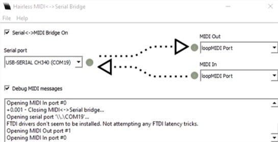

Step 4: Setting It Up to Be Recognized From the DAW Software
Arduino Nano and the Midi.h library that both DO NOT support USB MIDI function.This means that we will need to translate the data that the Arduino sends via Serial port to MIDI messages.
In order to do that we will need to install to our PC 2 FREE softwares :
- The LoopMIDI that crates a Virtual MIDI device
- And the Hairless Midi Serial that translates the Serial data that the Arduino sends to MIDI data so that it is recognized by the software we play music with.
In the DAW Software where we play music we must select the Loop MIDI as MIDI IN and MIDI OUT.
