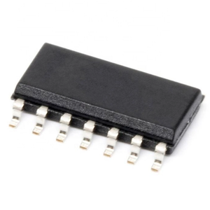

Step 1: Attiny 44/84

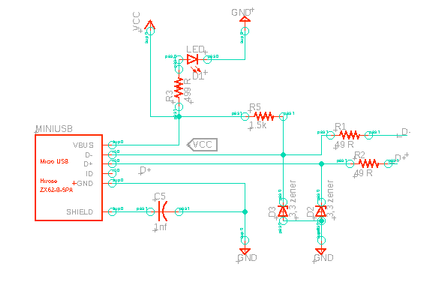

Step 2: Virtual USB (Attiny44/84)
"V-USB is a software-only implementation of a low-speed USB device for Atmel’s AVR® microcontrollers, making it possible to build USB hardware with almost any AVR® microcontroller, not requiring any additional chip."

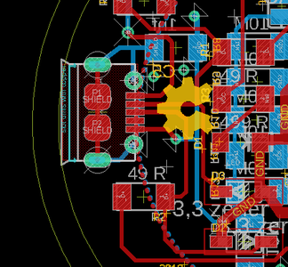

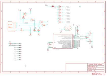

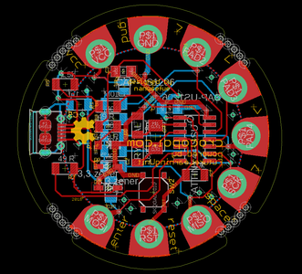

Step 3: Eagle PCB
the design of the plate was made with the eagle program, which allows you to generate the final files to be sent to any company that creates the final plates.
the design is intended to be single-sided to facilitate the welding of all components.
Eagle
