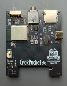

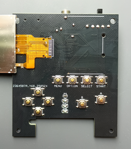

I started with the hotplate components first, which for me was the ESP32, the AMP (NS4168), the TP4056 and the USB C port. I find it easier to hand solder, so I just do the minimum with the hotplate.
On the back (pictured above) the only really tricky parts are the 16 pin USB C port, and the package at Q1. This Q1 component (UMH3N - a six-legged dual transistor) lacks an orientation dot. There is one on the PCB, and you must have the letter "H" nearest the dot. It goes without saying, you can't do any of this without magnification of some sort.
My recommendation is to complete the back completely, and then move to the front. Applying too much heat to the on/off switch or headphone jack will render them useless. Also getting too much isopropanol in any of the buttons will make them unreliable or stop working completely!
Step 2: Soldering 2
The front is straightforward. I soldered the screen ribbon cable last. The LCDs I used were Orange, Green and Red (from top to bottom). Cathode is on the left. Usually it's marked with a bit of green on the upper side of an SMD LCD.
As stated before, getting isopropanol in any of the buttons will make them unreliable or non-functional.
Not much to say about the screen ribbon cable. Get it bang in the middle. In the picture above it's a little off, but I re-soldered it. I tin the pads first, but you do you.

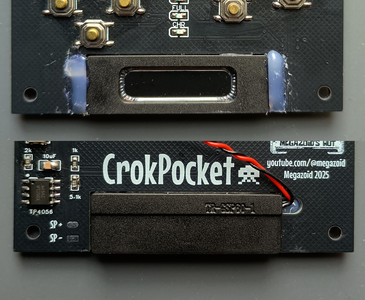

Before soldering the speaker, it needs to be glued in place. I went for a clear back on this version, so I hot glued it at the front.

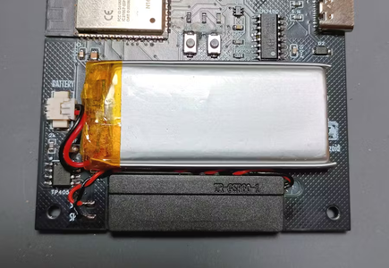

When attaching the battery, make sure the polarity is correct ! Some batches of batteries will have the red (positive) and black (negative) wires swapped around. I also shortened my wires quite a lot to give the exposed back a cleaner finish. A bit of double-sided tape was used to fix the 600mAh 602550 battery.

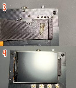

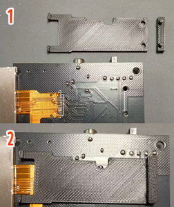

My method of screen alignment uses two 3d printed parts. Some might consider this odd, but it works for me. It also raises the screen about 3mm which is needed for the case design. The two pegs of the small "end stop" go into the larger piece. There are two holes in the PCB which the pegs legs also fit into. Once you are happy this all fits, I would use some thin double sided to attach it to the PCB.
Another small blob of double sided tape is applied as seen in image 3. The screen is then carefully pushed into place. For me this gave a perfectly aligned screen, but perhaps other people will have to make some very small adjustments?
If all else fails, you can just manually align and raise the screen with 2 or 3 strips of 1mm sponge foam double-sided tape. There is plenty of slack in the ribbon cable.

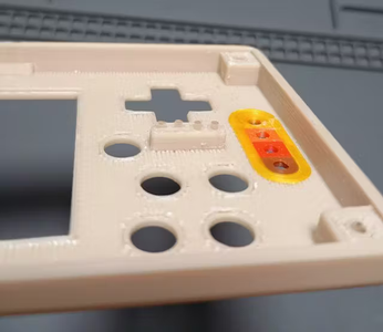

Step 6: Light Pipes
This is again a picture of PicoPocket, but the same applies for CrokPocket. I glued light pipes for the LED's using 1.3mm clear lawn trimmer line. On the resin printed front (pictured top and bottom of this post), I actually used 1.75mm clear Petg since the holes had less shrink.

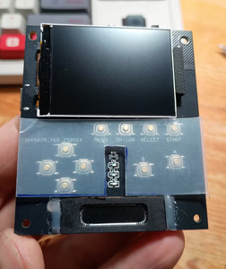

Step 7: Silicone Sheet
I used some 0.5mm silicone sheet to dampen the button's clickiness. This doesn't have to be that accurate. Just cut some sheet as shown in the picture. Without it, the buttons are going to have too much rattle and the wrong height. You could adjust them in CAD Software if you want to skip the silicone for some reason.

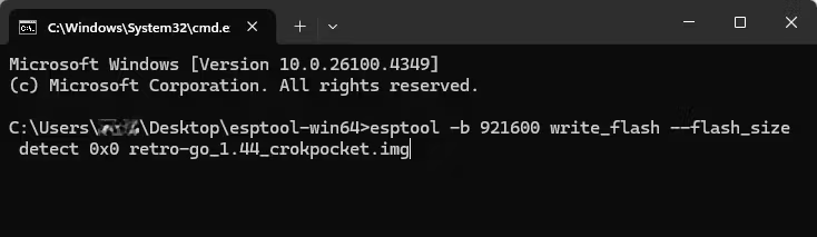

First upload the custom Retro-Go img file to CrokPocket. This can be done by first downloading Esptool and unzipping it on your Desktop. I used esptool-v4.8.1-win64.zip. Place the retro-go_1.44_crokpocket.img file (available from Github) in the same Esptool directory. Open a CMD (command prompt) instance in the directory.
Type in, or cut and paste the following command :
esptool -b 921600 write_flash --flash_size detect 0x0 retro-go_1.44_crokpocket.img
Make sure the CrokPocket is connect to the PC via a USB data cable. Make sure the CrokPocket is ON (and a battery is attached). Press ENTER and watch as your electronic brick is magically transformed in to a retro gaming handheld.
After this you will need to prepare a micro SD card. Copy the contents of the CrokPocket.SD.zip to your micro SD card. You need to find some game ROM's from somewhere. Add game ROMs to their respective roms/ subfolder
