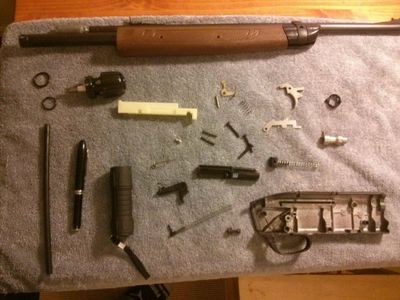

Make sure the gun is unloaded and any air pressure relieved. Then remove the three bolts from the receiver, and carefully pry apart to the two halves. A flat bladed screwdriver, guitar pick, or something other prying tool comes is handy here. If you want an adventure leave the bolt handle side down, and quickly separate the two halves. You will be rewarded by springs and other parts flying in all directions. Those who are less adventurous may want to flip the gun over and place the flat side of the receiver down. Open the two halves about an 1/8 inch and carefully remove the bolt hold open detent and spring. If you are careful everything else should stay in place.
Next take out (order is approximate): the interlock, interlock washer, and interlock pin; the cocking arm detent; the bolt knob and spring; the trigger, trigger spring, and trigger pin; and the sear spring, sear pin, and sear.
The barrel and the rest of the parts can now be lifted out. Just watch out as the tube plug and spring, and the BB pusher and spring will both go flying. The former can be avoided by putting a drift pin (or one of the bolts) into the middle bolt hole to hold everything in place.

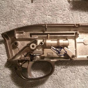

The contact surfaces on the trigger and sear looked pretty good. All of the grittiness appeared to come from the very deep tools marks left on striker. At the indicated spots I removed the tools marks on the sear with a 1000 grit stone, and then polished them until shiny with a 4000 grit stone. I took the same approach with the trigger. This was my first attempt at a trigger modification, so I just tried to remove a tiny amount of metal and not to reshape either part. I believe Crosman sells all of these parts, so one could get a little agro, and risk having to order new ones.
The striker required alot of work. I sanded it with 1200 grit sandpaper to all of the tool marks were gone, while trying my best to keep the angle constant. During the trigger pull the sear pushes the striker back about 1/16 of an inch, so changing the angle on the striker (or the sear!) here could help lighten the pull, or make the gun go off unexpectedly. Be careful.
The trigger pull on the 2100 feels a mile long (its ~ 1/10,560 th of that). There are several approaches one could take to lighten it. 1) Install a set screw on top of trigger, slightly back of the circle thing. 2) Shorten the sear. 3) Limit the travel of the sear. The first two approaches give a single stage trigger. The third produces a two stage trigger, which is what I was aiming for.
Its supposedly possible to drill and tap the pump tube and install a set screw to limit the sears travel. Being a fan of "easy" I elected to slip a 3/4" ID o-ring over the pump tube and into the grove that is conveniently there for some unknown reason. This produces a trigger that first requires a very light (and distinct )1/4" pull, followed by and 1/8" region where the trigger breaks like a carrot, albeit a carrot that has been in the fridge a bit too long. The result is less than ideal, but 10K times better than the factory trigger. Shortening the sear, or changing the striker/sear relationship could yield a very nice trigger, I suspect. The overtravel is a little large for my liking and I might add a pad or a set screw underneath the trigger to limit it in the future.
I was able to drop the rifle on its butt from about 3 feet, and on its side as well. In neither case did he rifle discharge. As such the trigger seems safe. YMMV.
