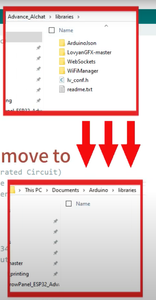

Step 1: Installing Libraries
Open Arduino and check the required libraries at the beginning of the code. These libraries are included in the downloaded files and should be placed in the correct Arduino library directory.

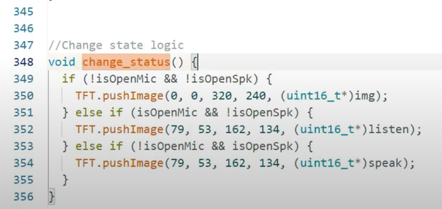

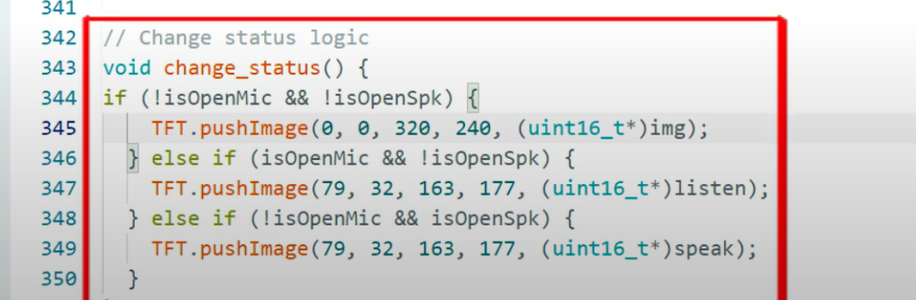

Step 3: Chatbot Workflow
● Pressing the boot key interrupts playback or wakes up the chatbot in your project.
● The robot icon updates based on speaker status.

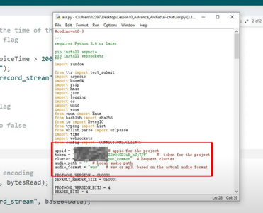

● The board controls the speaker and mic for text data and plays audio for binary data, processing it using asr.py (speech-to-text). Also update the API key, URL, and other needed in this file.

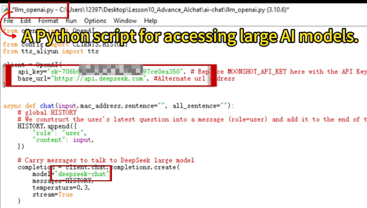

● The chatbot logic runs in llm_openai.py. Change the model, API URL, and key accordingly.

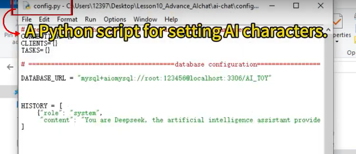

● In the config.py file, you’re the director! Customize the character to your liking, deploy it to the server, and watch it come to life, chatting with your development board in this ai chatbot project. It’s going to be exciting!
Step 4: Setting Up API Keys
OpenAI (Large Model AI API)
1. Log in to OpenAI and go to API Keys.
2. Click Create New Secret Key and save it.
3. Use this key in your code.

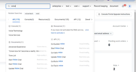

Step 5: Volcano Engine (Speech-to-Text & Text-to-Speech) Setup
1. Log in to Volcano Engine and go to the console.
2. Search keywords like 'voice' in the search bar.
3. Create a New Application and obtain the App ID & Secret Key.
4. Follow the API documentation for integration.

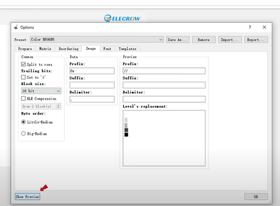

Step 6: Image Conversion for Display
1. Open the image conversion tool.
2. Select an image (the image size cannot exceed 2MB). Click on 'Options' -> 'Conversion'. Preset is R5G6B5 and choose 16-bit block size.
3. Click Show Preview, copy the generated data array, and replace it in the Arduino code.
4. Update the image size and coordinates in the main code file.

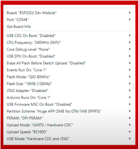

1. Connect the ESP32 HMI display to your computer and open the Arduino project. (Note: set the function select keys of the development board to 00)
2. Upload the code after setting the correct display size.
