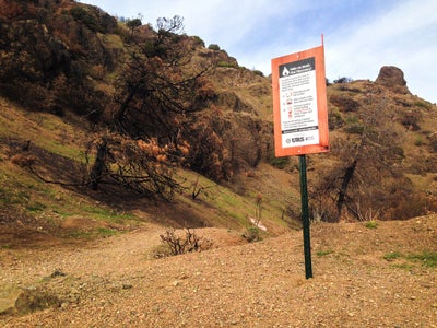

Step 2: Choose Your Sites
Here are some variables we considered:
- Potential for landscape change:
- We looked for places that burned and had obvious potential for change in vegetation
- We also looked for foreground, mid-ground, and background (to compose a pleasing picture)
- We made sure at least one of our sites was ADA accessible, and all sites were along frequently visited trails.
- Participants are going to try to post their photos immediately, which is a good thing. If you're relying on them to remember to do so when they get back to somewhere with cell, you're going to lose a lot of potential participants. If you have to install signs in places without cell reception, you might want to invest more in on-sign instructions, or in on-site training for potential participants.
As you can see in the photo, we used a tripod and some simple mockups to test each site based on an acceptable height for the sign. Accessibility requirements meant the bracket couldn't be higher than 48" off the ground, and had to be a minimum distance from the ground as well. Your requirements might be different based on the property owner and your own goals, so make sure you check with the folks who manage the land for any special rules and consider your audience and their physical capabilities.

Step 5: Make the Signs
Note: One of our organizers used to be a pro cabinetmaker. He has lots of tools and some skills. If you are not someone like that, try to find someone like that and make them do this part! Many parks have crews with lots of sign-making skills. Of course, short of that, plunge ahead and do your best. This is a pretty easy project if you are even slightly handy.
If you can sink your post into the ground, great. That's best and what we did in our main pilot at Mount Diablo State Park.
For a shorter installation (such as for our demonstration booth at Maker Faire 2014), we made concrete bucket-bases to sit on the ground. No installation fuss, but the signs can also get moved and then you lose consistency of photos. We'll describe both processes here.
In either case, since we were attaching angle brackets for camera positioning directly to the edges of the signs, we needed to mount the thin aluminum to a substrate that we could screw into on the edge.
A note on materials: For the Diablo project, we used 1x12 sustainably-harvested redwood for its weather resistance and decent screw-holding ability. But we had trouble with splitting. When we rebuilt the signs, we bought 3/4" marine-grade plywood from a local fine lumber outlet (MacBeath in Berkeley). There might also be plastic composite material with good edge-screw-holding properties, but we haven't found it. (Typical plastic lumber is poor on that count, and cheap exterior-grade plywood often has voids that also make it a poor candidate for this purpose.)
Here's a bill of materials for our three Diablo signs.

Step 9: Install the Signs
Install the Post
For T-posts, use a post driver -- those pipes with handles that are way easier than sledge hammers! Try to borrow one unless you're planing to do this a lot. Bring a level or plumb bob to make sure your signs go in straight, and be prepared for the post to twist as you drive it into the ground. Try to minimize twist, of course, but it's probably going to happen.
Attach the Sign
This basically just means screwing the sign onto the post, but make sure you attach it at a height that will allow you to attach your bracket correctly.
Attach the Bracket
Once the signs and posts are in, now's the time to actually attach the angle bracket to the edge of your sign. We waited until we were on site to do that to make sure we got the right shot. Make sure there's someone present who cares about angles and the images you'll get, because very small changes in the position of the bracket will produce very different images. We were able to screw some of the brackets in at slight angles to get the right image, and sometimes we attached the bracket to the side of the sign to get the right angle. Keep in mind that people may have trouble finding your bracket if it doesn't look like the picture on the sign.
