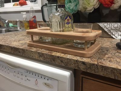

Introduction: Crown Royal Serving Tray
About: Husband, Father, Woodworker,

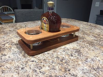

I was racking my brain on what to make or do for fathers day.
Tossed around a few ideas did some searching and here is the outcome.
The idea isn't original but I totally winged my plans on how to lay and cut everything.
Step 1: Getting Started
Wood is Cherry with Pine dowels
Cherry is 6 1/2in wide x 13in length x 3/4 depth
3/8 pine dowel
I didn't take pictures of cutting the wood and measurement layout. (Sorry)

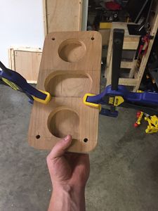

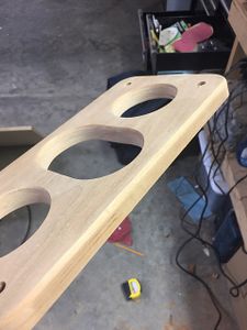

But here is the layout
Each hole for the cups are 3 inches.
The center bottle cut out is for a 750ml. Its 3 inch wide and 4 3/4 depth - Slightly important with depth and the way the bottle flares out towards the top.
holes are centered but everything is spaced 1 inch from each other 1+3+1+3+1+3+1 = 13

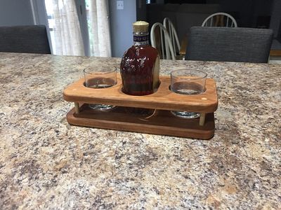

Step 2: Stacking/Shaping

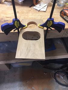

I took both my boards cut exactly the same minus the holes for the top to shape the curves.
I rounded my corners 1 inch (using bench top belt sander).
Keeping them stacked I went to the drill press. Using 3/8 forstner bit I completely drilled through both top and bottom.

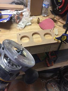

Step 3: Sanding/Routing
I pulled out my osculating sander and did my best sanding the center holes then tried to finish up with hand sanding.
Using a round over bit I did a slight rounding to ever side.

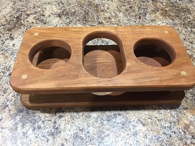

Step 4: Adding Dowels and Sanding
I will remember next project to take more pictures

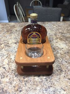

The wood is 3/4 top and bottom. so 1.5 inch total
I cut the dowel to 3 inch total you will need four pieces this leaves 1.5 inch for the opening
Sanded everything down to 220 grit
Step 5: Finishing

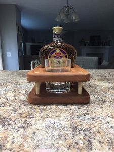

I finished mine in teak oil. This was after about 3-4 coats. I actually went back and added another 3-4 coats and turned out a bit darker and the grain popped even more.
This turned out to be a successful fathers day gift for my dad.
Good luck to everyone that gives it a try.
Happy to answer any questions.
