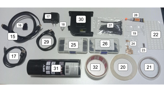

Electronic parts:
  1. [1] Raspberry Pi Zero 2W
  2. [2] 5MP OV5647 flex cable Pi Zero camera
  3. [3] 3.7V LiPo battery (Probably won't be able to find the exact battery I use, will need to find a good sized one and edit Onshape project for it to fit. Recommend roughly 600-800mAh, depending on how heavy or large vs. runtime you want. Make sure it's thin, mine is a cheap generic 600mAh, 60x20x6mm battery. Definitely would not recommend, find a high quality, lightweight one with more capacity.)
  4. [4] Micro USB TP4056 charging module
  5. [5] I2C ADS1115 ADC module (purple board)
  6. [6] I2S MEMS microphone (SPH0645LM4H)
  7. [7] 0.96" 80x160 RGB TFT display module
  8. [8] Mini DC-DC 5V step-up boost converter
  9. [9] Flat Kailh silent push buttons (x3)
  10. [10] Generic DPDT slide switch with screw holes
  11. [11] Single sided perfboard
  12. [12] 30AWG silicone wire (preferably 7 colors, 1 meter each should be fine)
  13. 26 or 24AWG silicone wire (red and black, for long power wires, 1 meter each)
  14. [13] Magnetic Micro USB tips (x2, only one in the picture)
  15. [14] MicroSD card (I personally used a "SanDisk Extreme PRO 64GB A2 V30", but do some research.)
Other parts:
Raspberry Pi related
  1. [15] HDMI cable
  2. [16] Mini HDMI to HDMI adapter
  3. [17] 2A brick and Micro USB cable
  4. [18] Micro USB OTG adapter (Male Micro USB to female USB A)
  5. Keyboard
  1. [19] 34mm diameter generic acrylic VR lens (recommend getting more than 1 just in case, very cheap)
  2. [20] Clear double-sided tape (should be a bit thick, I think it's called "nano tape")
  3. [21] Thin double-sided paper tape
  4. [22] Glue tack
  5. [23] 8x3x2mm neodymium magnets (I used a total of 8, so you should get at least 10. If you can find the right size, just get small rectangular ones, but ensure they're 2mm thick. Also check the Onshape project to ensure they'll fit properly.)
  6. [24] 8x10mm mini hinges (Usually used in dollhouses and jewelry boxes, they're gold/brass colored. These glasses only use one, but definitely get at least 5.)
  7. [25] M2 Phillips self tapping screws set (My set is 800pcs, from M2x4mm to M2x16mm, here's the full name on the box: Black Zinc-Plated Carbon Steel Pan Flat Head Self Tapping Screws Metric. Although the box says pan head, they're actually countersunk. I recommend a countersunk screw head shape over pan head, since they keep the 3D printed pieces from moving around better, from my experience.)
  8. [26] Micro Phillips self tapping screw set (Mine goes from M1x3mm to M1.7x6mm, I recommend M1.4)
  9. [27] Small zip ties
  10. [28] Super glue
  11. [29] 540 degree magnetic charging cable (Mine has a built-in LED on the charging end, cool. Make sure it's not a data cable, because then it's finnicky to clip on, because you need to align it right.)
  12. [30] Power bank (Optional if the glasses' built-in battery is powerful. In my case the battery should only be used to keep the glasses running for a short time when momentarily unplugging the main Micro USB PWR cable. Crypta Glass External Battery Pack coming soon!)
  13. [31] Spray paint (If you want to paint the perfboard to match the rest of the glasses)
  14. [32] Masking tape (for perfboard painting)

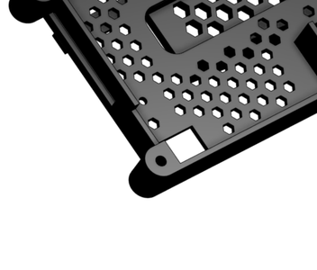

Step 1: 3D Printing
I used my trusty Ender 3 V2 to print all of the electronics housings and other parts. Based on some quick research, I'm quite sure PLA is the lightest material you can use that isn't extremely expensive, although I might be wrong. Either way, you might want to try printing with an exotic filament, like carbon fiber infused ABS, or something else unique.
I exported my Cura Slicer print profile to make it easier to get the exact same prints as I did. Instructables doesn't support .curaprofile files, so here is the official CryptaGlassV2 GitHub repository. The STL files can be found below, or in the repository. Be warned though, there's a very high chance the glasses clip, distance from display to lens, and other aspects of the design will not work with your glasses or eyesight. I actually had to stick the lens on the inside of the glasses lens because the display was too close to my eye (not ideal). If you have some solid Onshape experience, feel free to try editting the Onshape project yourself. Please let me know how confusing my sketches are... this is my first time ever using Onshape for a project.
Things you'll need to change:
  1. Display arm length
  2. Display arm magnet slot positions
  3. Arm slider placement
  4. Main case lid magnet slot
  5. Glasses clips shape
  6. Top clip shape
  7. Battery compartment dimensions
  8. Display angle
  9. Most likely more I haven't listed
If you'd like to use the exact same glasses as I did, I might be able to order and ship them to you soon. There are many prescription options.

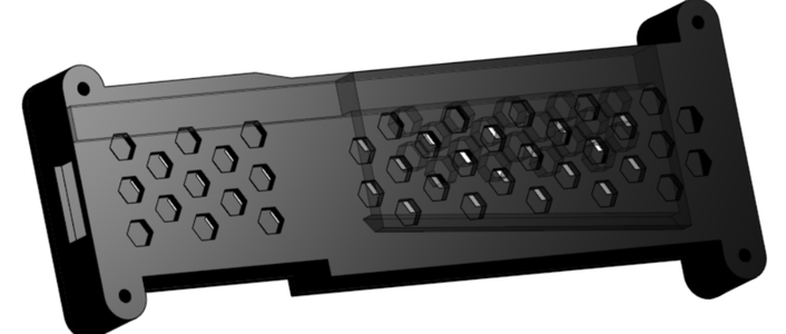

Step 3: Attach Clip to Main Electronics Case (left of Glasses)
  1. Find "MainElectronicsCaseClip" and "MainElectronicsCase" 3D prints
  2. Remove all supports carefully and file down where needed
  3. Gently try test fitting the Raspberry Pi, inserting the ports into the holes at an angle first, then follow through (Usually shouldn't fit first try, this is intentional. Using a knife and file, cut down the wall extension, refer to Onshape image above, until it fits snug)
  4. Using the thin, 1mm thick guide built into the clip, align the bottom edge of the protruding bar to the top edge of the large cutout in case (refer to Onshape image above)
  5. Apply small drops of superglue to the contact area of the clip, avoiding gluing the guide bar (might need to snap it off and adjust later)
  6. Cut guide bar off using side cutters
  7. Test the clip on your glasses, should be a perfect fit and not slide back and forth too much, just a few millimeters (if loose or unsatisfied, snap clip off carefully by cutting the corners of the glued edges flush using side cutters, then redesign and reprint)
  8. Enlarge screw holes on perimeter of MainElectronicsCase with 1.5mm drill bit

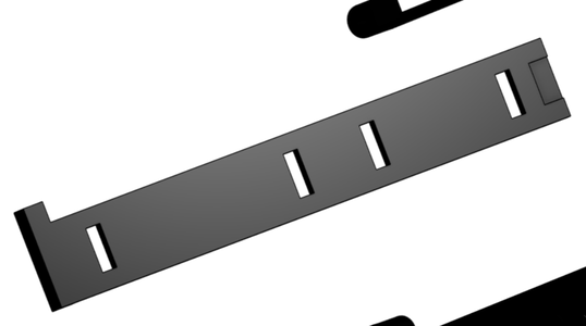

Step 16: Attach Display Assembly to Electronics Lid Case
Find the "ArmSlider" and remove the tiny support under the small temporary guide bar. Check whether the display arm slides in it smoothly. If not, you'll need to sand either the arm or slider depending on any imperfections you notice. Then add a magnet into the slot. It should be a perfect press fit right off the printer. If not, file down the inside edges a bit. Drip superglue around seam to lock it in.
Refer to the image above that shows where the slider should be glued onto the lid. Keep in mind that you might need to change this based on your tests from Step 5.
Add magnets into every magnet slot, ensuring opposing polarities are facing each other where desired (refer to images). The magnet slot built into the case and lid is split in half by the case and lid, so glue that magnet into the case, not the lid. The lid magnet slot will slide over the case magnet slot.
The slider gap was designed to be thicker than the display arm, so that you could sand it down to your liking. Now put the arm into the slider in the orientation showed above and glue the slider into place, ensuring the magnets in the arm align with both the slider magnets and lid magnet.
Note: Screw hole near the lid magnet slot prevents display arm assembly to be positioned down any further that it already is. Will be redesigned soon.
