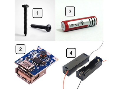

Parts:
  1. [1] Long M2 pan head screws (10-15mm long should be fine)
  2. [2] 134N3P single USB power bank module
  3. [3] 18650 battery
  4. [4] 18650 case
