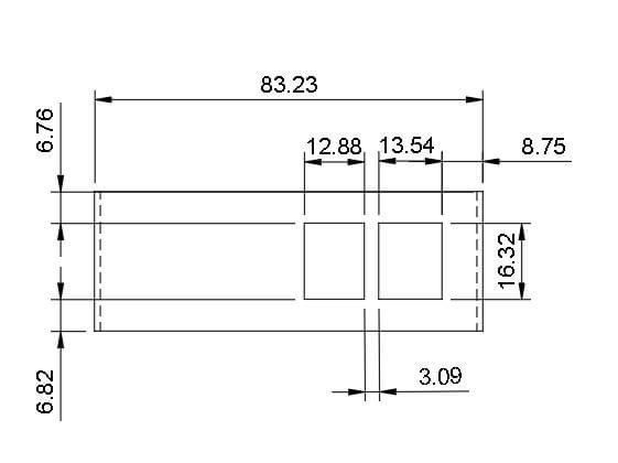

Step 8: 3D PRINT: THE SECRET KEY PIECE
The design of the part was made with AUTODESK FUSION360.
Use a 3d printer to create the part. I have a Creality Ender 3 Pro.
I suggest printing face down as seen in photo 3 (Cura software).
In my case I used black PTEG filament, but you can also use PLA.
I include the file to print.
** EDIT 8-DIC-2021**
I added 3 additional images with dimensions of the secret piece, to check the measurements with your print.
