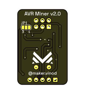

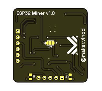

Step 3: LED Status Indicator Configurations
All the Miner boards have an onboard LED for status indication. Also, the Common Miner Baseboard has onboard LEDs for a convenient status indication of the MIners.
You can choose between the onboard LED or baseboard LEDs to use for status output. The AVR-Miner Board & the ESP32-Miner Board have jumper pads at the back which can be shorted/connected to achieve the desired status LED configuration.
By default all the jumpers are open, so you won't be able to see any output via the status LEDs.
Following are the Jumper configurations:
1) AVR-Miner Board
LED Configuration Jumper: JP1
- Short Pads 1 & 2 for onboard LED
- Short Pads 2 & 3 for baseboard LED
- Short all pads for both onboard & baseboard LEDs
2) ESP32-Miner Board

1) ESP32-Miner Board
- When using the ESP32-Miner Board as a Master for the AVR-Miner Slaves, short/connect the Pads for R3 & R4
- When using the ESP32-MIner Board as a standalone miner, disconnect the Pads for R3 & R4.

1) The first step is to burn the bootloader to the controller for setting the clock configuration. If you are using a controller with a pre-loaded bootloader you may skip uploading the bootloader to it. Select the appropriate Board Name from the Tools menu as per the microcontroller used on AVR-Miner Board. For example: If the AVR-Miner has Atmega328 on to it, so you may select the Board as Arduino Nano. If it is Atmega8, then you may select Arduino NG (Atmega8).
2) Select the Upload Using Programmer option from the Sketch menu to upload the respective code to the AVR-Miner. Make sure you change the I2C address in the code for every different AVR-Miner Board.
