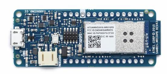

Arduino MKR1000

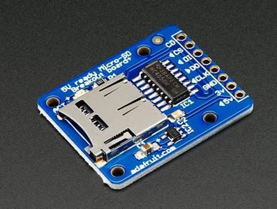

Adafruit uSD breakout.

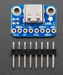

Adafruit USB C breakout

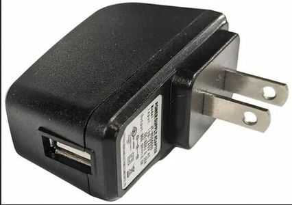

5vdc (1 amp minimum) wall transformer w/ USB A to USB C cable

However, the Seeeduino does not have the WIFI necessary to connect with the Davis weather station. I tried making it all work with the ESP8266 that I used with the ePaper display, but there are too many differences between the AVR processor architecture of the Seeeduino and that of the ESP's. That led me to the Arduino MKR1000.
I was still not out of the woods yet as the MKR uses a SAMD based processor.

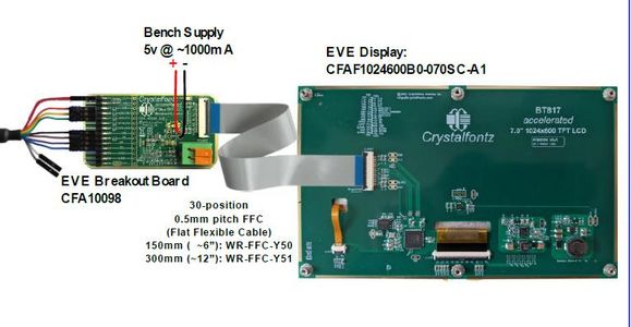

The first step was seeing if the demo sketch provided with the Crystalfontz display kit would compile with the MKR1000 selected as a board. I had to make some changes to the pinout definitions before I started the compile. The display sketch include defines that were specific to the AVR:

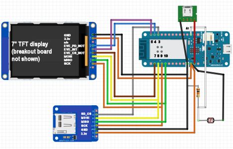

The rest of the pinouts are as follows:
// Wiring for Arduino MKR1000 connected to CFA10098 breakout for testing.
//  MKR     | Port | 10098/EVE          | Color
// #6/D6    | PD3 | DEBUG_LED          | N/C
// #5/D5    | PD7 | EVE_INT            | Purple
// #4/D4    | PB0 | EVE_PD_NOT         | Blue
// #7/D7    | PB1 | EVE_CS_NOT         | Brown
// #3/D3    | PB2 | SD_CS_NOT          | Grey
// #8/D8    | PB3 | MOSI (hardware SPI) | Yellow
// #10/D10  | PB4 | MISO (hardware SPI) | Green
// #9/D9    | PB5 | SCK (hardware SPI) | White
//Arduino style pin defines
// Debug LED, or used for scope trigger or precise timing
#define DEBUG_LED  (6)
// Interrupt from EVE to Arduino - input, not used in this example.
#define EVE_INT    (5)
// PD_N from Arduino to EVE - effectively EVE reset
#define EVE_PD_NOT (4)
// SPI chip select - defined separately since it's manipulated with GPIO calls
#define EVE_CS_NOT (7)
// Reserved for use with the SD card library
#define SD_CS      (3)
//#define MOSI_PIN   (8)
//#define MISO_PIN   (10)
//#define SCK_PIN    (9)

At this point I temporarily hooked everything up and verified that the demo program worked as it was designed.
Success! Now on to make the display show the weather data.
