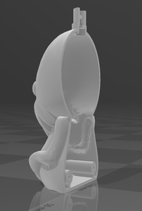

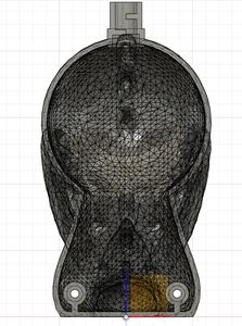

I'll briefly go over how I would go about it again:
  1. Found an STL of a monster I liked (Credit: drukdrukdruk_pl for their Cute Cthulhu Walker Closed)
  2. Pulled it into Fusion360 as an STL
  3. Eyeballed position so I could slice it in half later
  4. Designed the thing for the screws to secure the two halves together
  5. Designed the top cable trap
  6. Made the top cap with a hole for the grommet
If you want to go over my fusion file it's on Github (sorry it's so messy - I really struggled with some parts doing this project). I woulda attached it here, but the file size is too big.

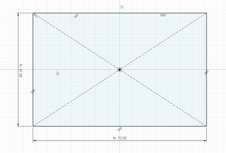

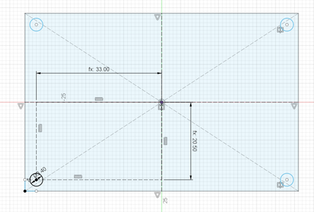

If you need to (because your electronics are different), or want to, designing a box is relatively simple and there are plenty of decent tutorials out there on the topic.
Or, if you want to just alter my designs some, all my working files are attached and you can edit them as required. You can use my files and edit the dimensions as you require to make your housing work for you. Upload your remixes as remixes on Thingiverse to help out others šŸ˜
  1. Start off with defining dimensions that are essential - Board size and where the mounting holes go. I followed the schematic of my protoboard.
  2. I measured where with relation to the circuit board I needed my button hole to be, and how big my button was so I could place this hole.
  3. Then I measured using my calipers how far away my potentiometers were from the base and centre and how big the holes needed to be.
  4. Then make a box that will fit your circuit and components, with holes for the cables to go in and out of it from the power bank and to the Cthulhu and slice it to be two halves.
  5. Then you make your box, with whatever design choices you have, such as style, and how to join it (snap fit or using screws) etc.
