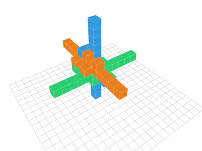

I use Voxel Builder to prototype my mechanical parts. Then I make cubes from paper. These paper cubes can't be twisted because of the corners. This is just like playing Minecraft :D
As the corners are blocking us to twist, we need to go round. For the mechanical parts, I use bamboo chopsticks. They have 0.5 cm in diameter and that's is where I started calculating the box size. There you can see my scratch on a paper.
Cut 15 cm of bamboo chopstick as the base stick. Mark the center. Make 3 pieces of 1 cm stick and 8 pieces of 0.5 cm. Curve one end of the small pieces to be stuck on the main sticks. Align and glue the pieces as the models we made before using Voxel Builder.

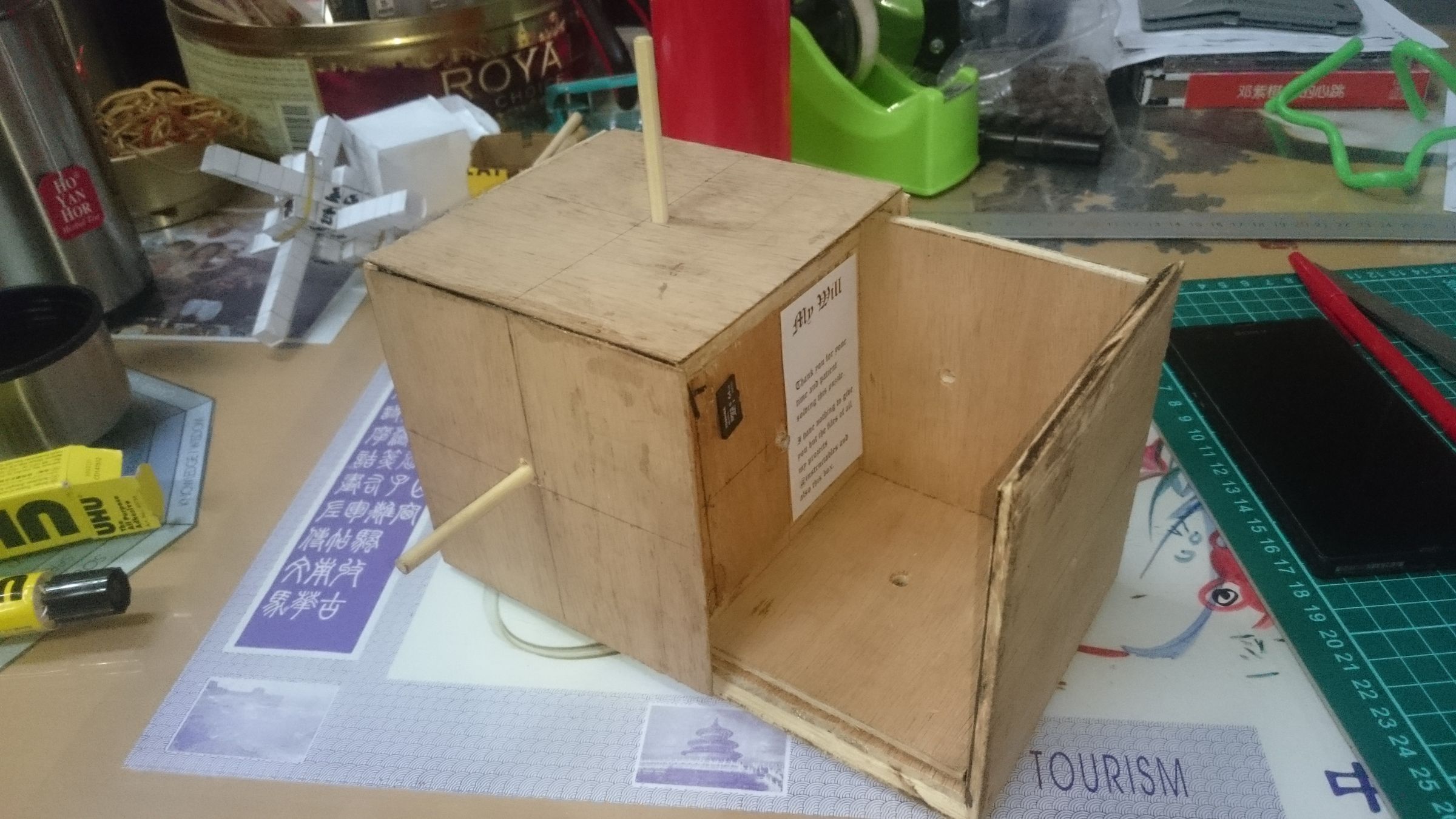

Step 8: Assemble the Box
Do this piece by piece. You need to drill holes on every side just the same as the inner cube.
You should pay attention on which parts are glued together. When the box is unlock, we split the box into two parts.
One part consists of one side cover, one bottom cover, one bottom lock and one side lock those are glued together. The rest will be the other parts glued as one piece.

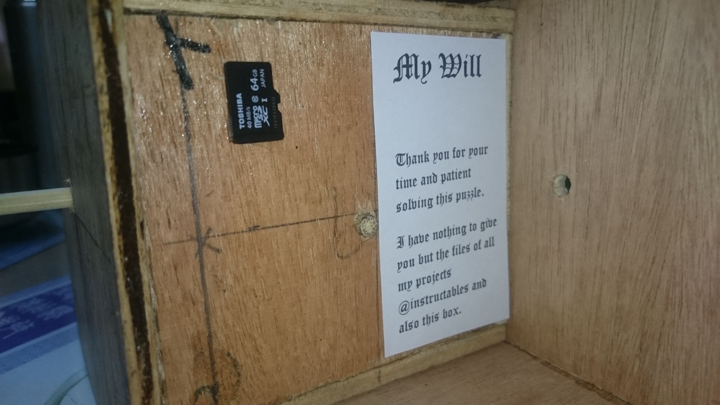

I am planning to put "My Will" inside this box and the one who solve this puzzle can have all I have. What do I have?
