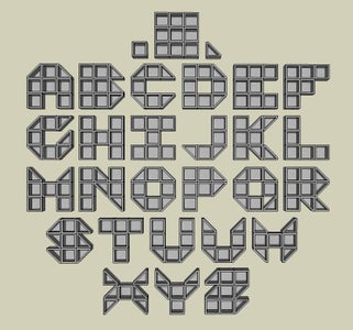

This is a design to help you create any word you like as shelves using a simple cube and diagonal half cube. 2 small shelves, with an alphabet of possibilities. The shelves are designed to hang on a wall, but suggestions are included if you would like to set them on a flat surface.
I will suggest how to make the cube and half cube - but this could depend on the overall size of the word you are creating or what you are putting on the shelves.

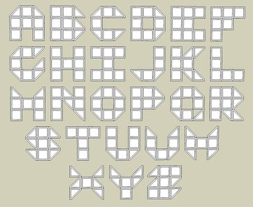

Using cardboard, or some other stiff paper you can draw on, writing out your word in the cube form at the approximate size you would like.
To do this start by drawing or printing and cutting out the template above the number of 9x9 squares to equal the number of letters in the word you are writing. Use a spacing of 1/2 of a cube width between letters. If you don't know what size of object you are using chose a 9x9 cube size that feels right. The spacing between letters should be 1/6 the width of your 9x9 cubes.

With the size of boxes, 9x9s and the spacing the word can be laid out as in step 1. Using the strip guide with the 45 angle at each end to form the diagonal blocks. Note that the point end of the strip matches into the corner of the box to get the desired shape.
Of course you could just print out the above guide at the size you need an cut out the letters.

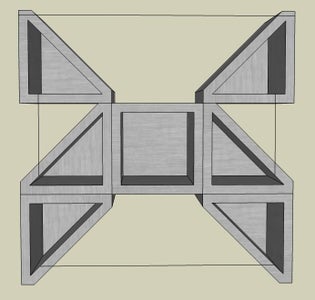

Step 8: The X
The X is easy to mount if the top 2 sections are mounted as well as the main body. However, if only a couple of mounting points are used, the top two diagonal pieces will likely want to part ways with the main body. What I suggest is a loop of fishing line around the edges of the X as shown in the picture. All edges will need to be done so it all stays in tension.
The image shows where the fishing line should go. Note that small holes will need to be drilled through each piece of wood so the line passes through it and then tied off on the outside with a knot big enough that it won't be pulled back though the hole.
