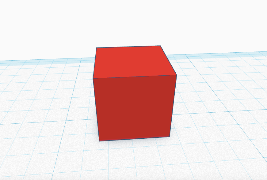

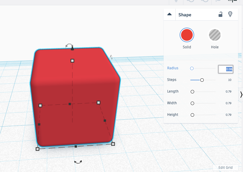

To start, I brought in a cube. Pretty simple :)

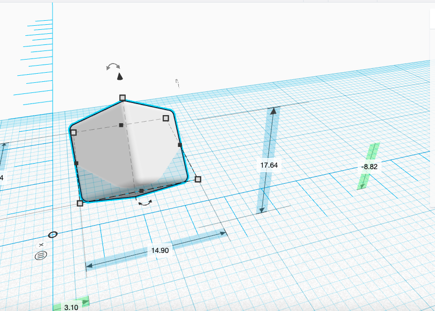

After tests, I decided I wanted to soften the cube up a bit so the tips wouldn't be too sharp. So, I changed the radius to .06.
Next, I did some rotating so the tip pointed up and it was just generally out of whack. When I had it the way I wanted it, I moved it down so that it was halfway down.

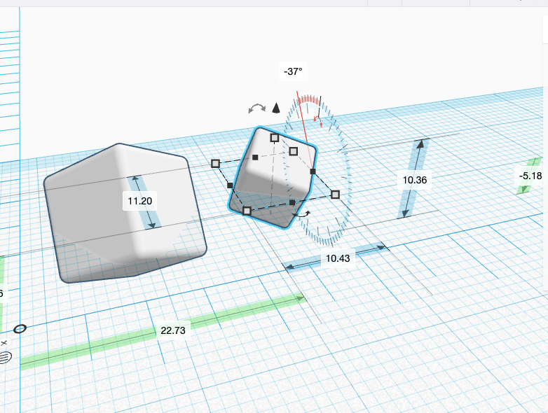

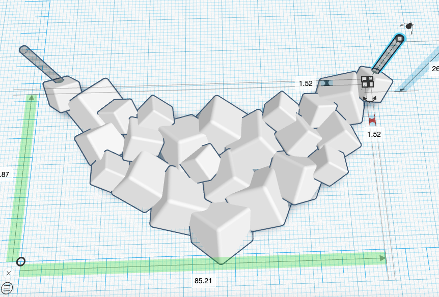

Copy, paste, shrink, and randomly rotate the cube.

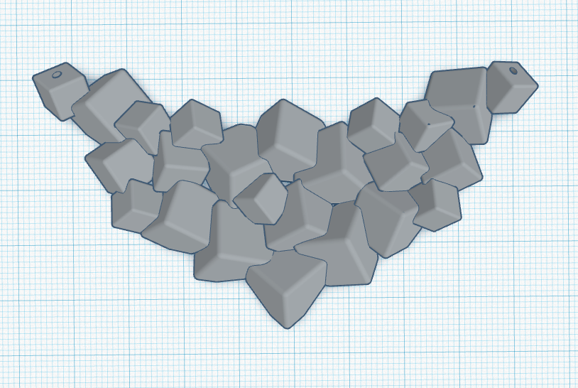

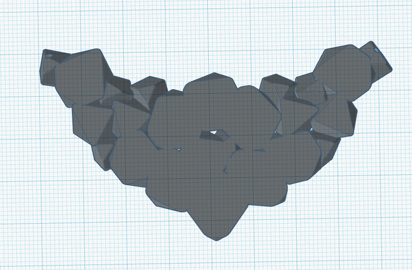

Repeat this and orient them the way you want. I actually did half the cubes and then copied and flipped them to make the other side. Then, to mix things up, I randomly went in and did some rearranging. Keep in mind the size of all the cubes together. My pendant is 3.4" wide by 1.9" tall.

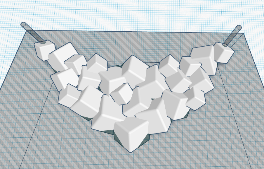

Right now, they should all be aligned in the center. You can leave it like this if you prefer that look (see the images at the top that compares the black, silver, and white pendants).

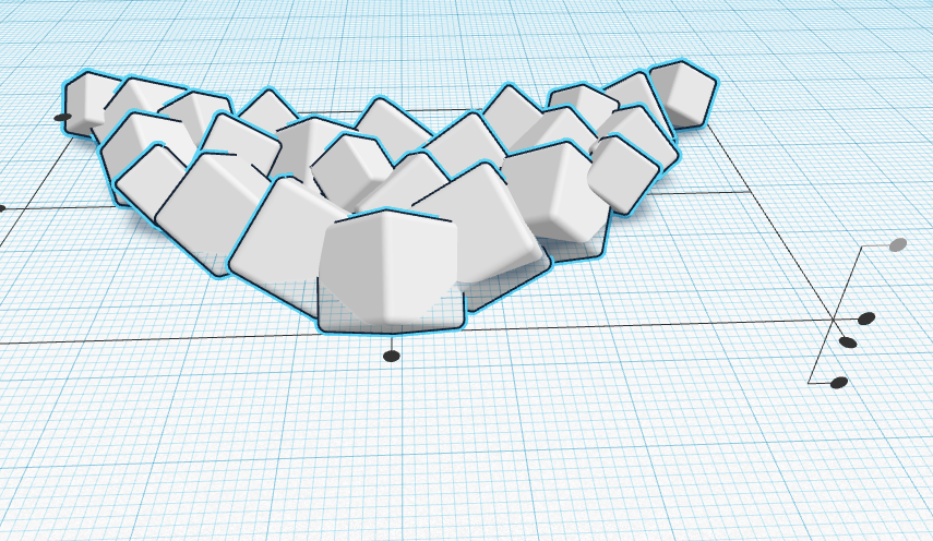

Othersie, highlight them all and align the top.
Lastly, you need the holes. Line them up the best you can, but if the cubes aren't oriented the same, it won't matter too much. I would say, just align them so are at least even that way.
To finish, finish the pendant, put a hole from the center line down and just cut the whole back off to make it lie flush against you.
Here is a look at the finished pendant from the top...
...and the flat bottom.
