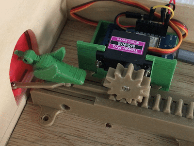

For the windows I printed fancy parts because this is easier to make but you can make this also of wood parts
Make sure the frame with the shutters run smoothly. You need some filing to get to.
For the hinges I used 2mm ashes, cut two of 30mm length. The holes have to be drilled afterward to make it run smoothly.
Also make sure the tooth rack glides smoothly.
To make a good link between the shutters and the rods I used M2 metal inserts. If you don't it might get loose after some while.

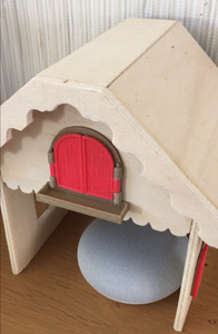

Step 2: Jigsaw House Parts
You are free to build and design your own cuckoos-house but I added mine to get started.
Parts to jigsaw:
  • 2x side walls with window hole
  • 1x floor for mechanism
  • 2x roof slope and 1x middle flat part
  • 1x ornamental front
  • 1x front top
  • 1x front bottom (optional) before google home
The window openings are needed to talk to Google home and hear the sound of it.
Step 3: Building House and Mechanism
  1. Glue 3D-printed windows to the side-walls
  2. Glue side walls with floor and make it stand horizontal
  3. Bore holes in the floor to mount the mechanism
  4. Mount the mechanism with the bird, rods and shutters. If it suits well, you can glue the shutter frame to the wooden front.
  5. Mount the servo with the pinion to the 3D-printed body. To test you can use a servo-tester.
  6. Glue roof parts, the roof is kept loose to take away for problem solving and make adjustments.
