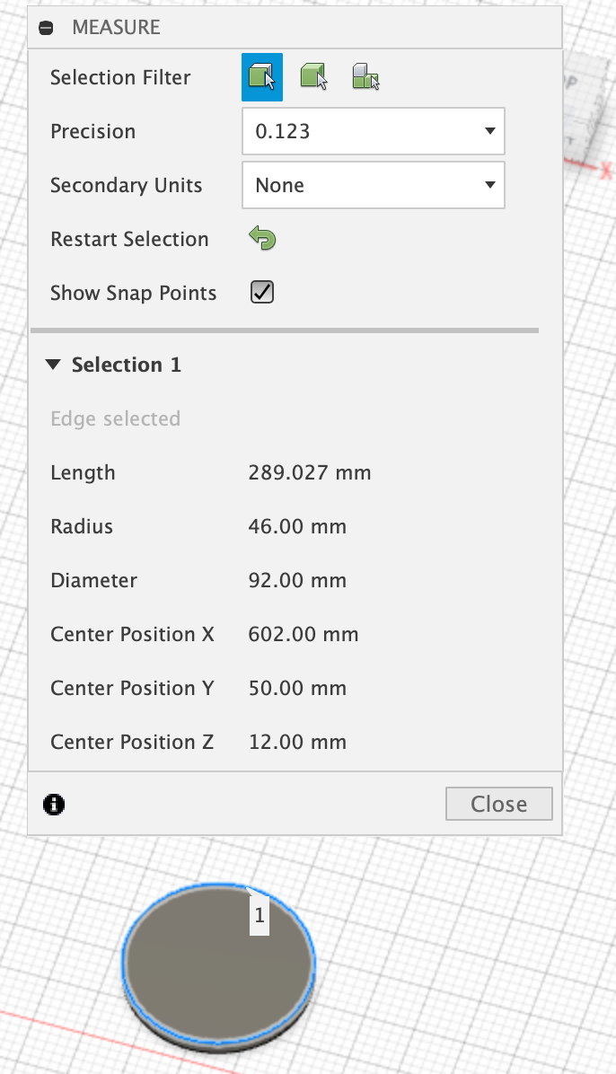

To begin, you will need measurements of a Solo cup. The diameter of the top of the cup is 92 mm, which is what the diameter of each of the placeholders will be. Click on "Create" and make a cylinder with a diameter of 92 mm and a height of 8 mm. After doing this, make ten duplicates of the placeholder and put them in the formation of a triangle (picture included). Make sure that the space in between the placeholder cylinders is as minimal as possible.

Start with the first placeholder cylinder on your plane and place it in the lefthand corner of the base. Next, move the placeholder cylinder up by 4 mm by setting the Z-distance to 4 mm, so it is partially intruding and partially extruding the triangular base. Copy this cylinder and paste a new one. Then, move the new placeholder cylinder 100 mm right. Continue this step until 10 placeholder cylinders fill-up the triangular base in an equidistant formation.
