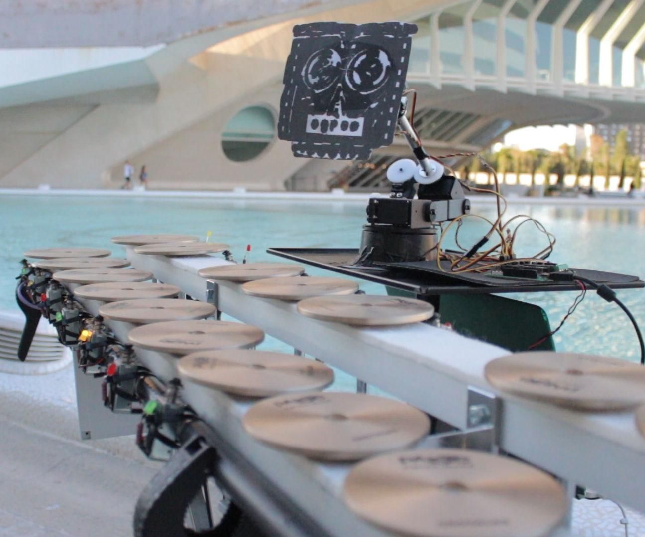

Curiosibot is basically a Robot that can play a percutive instrument, in this case the Crotales, and it can be control by any program that runs MIDI via Max/MSP. It play the instrument via the hit of a solenoid under the Crotales and create the note.

Step 2: The Mechanical Part
This part would vary depending what instrument would you like to
play, but I would guide you with the Crotales.
As you see at the image there are different options to play the interment, you can use Pull down solenoids attached to a metallic bar to play each note, or use push ups for hit the Crotales from below.
For my project the best option was to use a bar where all the solenoids can be placed and run the cables there, so when I need to attach the mechanical part to the actual instrument I can do it without damaging the instrument.
Also I put LEDs on each solenoid so you can see when its activated. Thats easy, you can use a 2.2KΩ resistance running directly from the solenoid, like the image.
