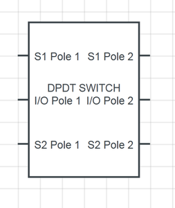

Step 2: The Circuit Explained
[Note: While the below is a valid explanation of the shown circuits, those circuits are not the best for this project. I'm planning to redo this guide but in the meantime replace the DPDT switch with a TPDT (triple pole). Tie the grounds to the additional pole in the same way the other lines are attached.]
The circuit is quite simple, really. A true DPDT (Dual Pole, Dual Throw) switch, not dual pole center off/on, isn't really an on/off switch. As the word switch implies it switches between two different circuits with two leads. This means one of the two circuits is always on, while the other is off.
Think of it as a railroad junction: Two rails are running along and come to a branch, with two rails going in two directions. The junction is the switch, it connects the original two rails to the corresponding set on one of the branches. Just like our audio switch will be able to switch between outputs or inputs, so can the rail junction. It can direct trains coming up the single track to one side or the other or if there is a train on each branch it can select which one gets to continue on the single line.
If you're more confused now just take a look at the diagrams of the switch and circuit. The left and right audio channels are the two rails and the grounds are all tied together.

Measure the inside of your container and cut the proto board so it will fit inside. Now decide on the layout you want. I chose to place the single input/output alone to the left and the switched plugs in a vertical line to the right with the switch sliding parallel to the two ports. With the position determined, solder the components in place leaving the upper posts on the jacks alone, for now.
Double checking that you are connecting the right pads, wire everything following the circuit diagram. To prevent mistakes make the connections in order, either all of one channel to switch (left I/O, left S1, left S2, then right, then ground) or jack by jack (I/O left and right, S1 left and right, S2 left and right, then ground).
When everything is in place test it out. You only need one input and one output, just test it in S1 by flipping the switch (it should be playing when the switch is close to it and off when it is away) and then repeat in S2.
