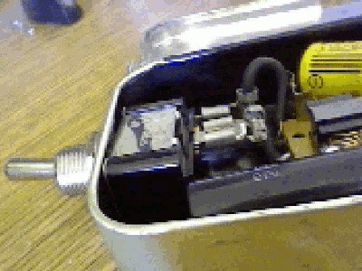

Step 2: Connect Wires
*Optional* To make your shocker pulse rather than discharge in a single powerful shock remove the capacitor and connect the wires to the 2 terminals where it was located rather than the capacitor leads I mention below.
Connect 2 wires to capacitor as shown, soldering if desired.
If you have a 4 leg button: test your push-button for continuity (resistance) using the ohms setting on your multimeter or a battery a wire and an led. Figure out which legs are not normally connected to each other when the button is not being pushed.
Connect a wire to one of the normally closed sides of the button and connect the other side of the normally closed button to one of the wires connected to the capacitor. Look at the picture for clarity if you are unsure of what I mean.
Connect the wire leading from the capacitor to one of the nails you will be using as a shock probe. Connect the other wire, the one leading from the button, to the other shock probe.
If you would like the capacitor to charge fully before shocking your victim: connect the 2 pads where the charging button was connected to with a wire see pictures for more info.

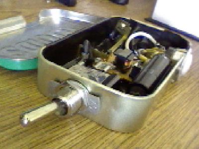

If you would like to regulate the strength of the shock your victim gets: Get switch or button of some type and connect 2 wires one going to each side that connects when the button. It doesn't matter which wire you connect where. I used a toggle switch as seen here.

Step 3: Drill Holes for Buttons and Shock Probes
Find and mark off a good place to put your shock probes. Drill or punch two holes about the same diameter as your shock probe (your nail or other metal object) in the Altoids tin for the the probes to go through. Use a wood block to prevent the Altoids tin from bending. See picture for more help.
Put your circuit-board inside your Altoids tin to test it for size. Make a note of where the button will fit good and be easily reachable. Mark a place where you want the button hole to go. Drill where you marked the hole.

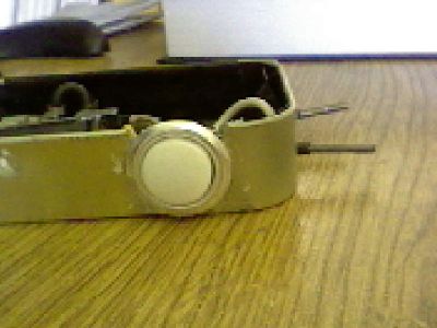

Step 5: Glue in Your Shock Probes and Button
Important: Wrap your shock probes in electrical tape.
Glue probes (using silicone or another metal compatible glue) into the holes you drilled.
Glue your push-button in as well making sure it is in a good place to push.
Wait the amount of time necessary for the adhesive to dry.
