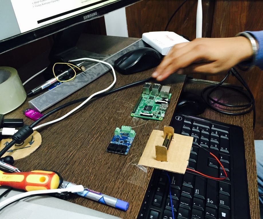

Step 2: Make Connections
1. Take Raspberry Pi and GPIO header
2. Connect the GPIO Header to the Raspberry Pi’s GPIO pins.
3. Using an I2C cable,connect the Current monitoring controller to the Raspberry via the I2c connecting port on GPIO header
Step 3: Turn It ON
1.Pass the live wire to the Bulb through one of the current ports in the Current Monitoring Controller.
2.Turn on your raspberry pi , which have a linux installed on it.
3. Power up the board(Current monitoring controller).
Raspberry Pi can be powered by any Micro USB adapter. It works on 5V and 2A. 7. Input voltage to the Current monitoring controller is 12V and this can be given by a 12V adapter 8. Now this board is ready to be used.
