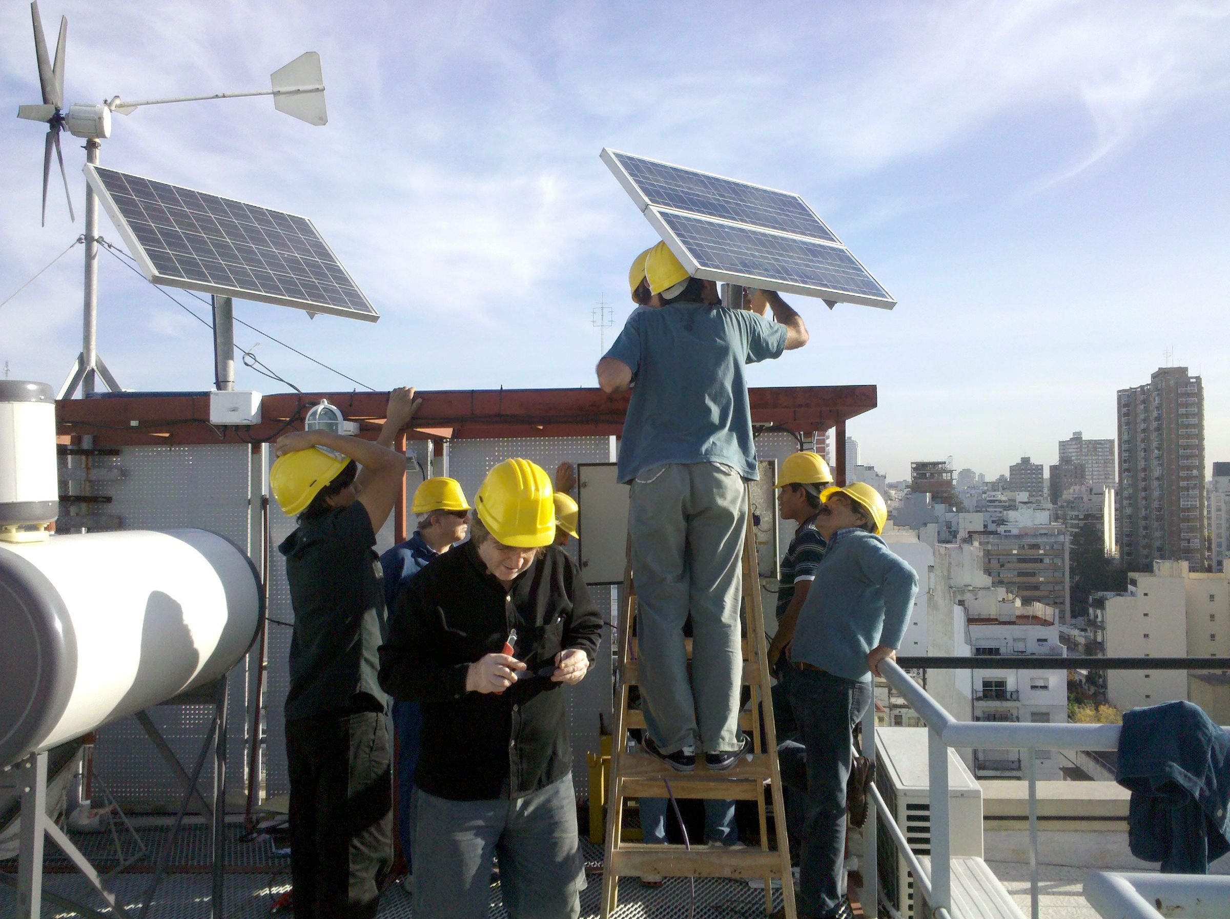

Step 3: Resource
Lets go now with our resource.
Here you will have to do some research, since I can only provide some data from my country and city as an example, but you could found that data on the WWW.
Ask around, and it will reveal to you.
As a first impression I have to say that is quite easy to acquire this data.
One of the things with solar modules is that they work it's best when they are at 90º to the sun rays. So, if you could afford a solar tracker, or you are skilled enough to make one, good for you, this is almost solved.
But there is some things to take into account:
In southern hemisphere, your panel should be facing south.
In northern hemisphere, it should be facing south.
This is you ORIENTATION.
Now, the next thing is INCLINATION.
To choose the best inclination for your modules, if they are going to be stuck in one position is the one according to this table:
Your Latitude | Angle of the panel
| In Winter | In Summer
0º to 5º | 15º | 15º
15º to 25º | Your Lat. | Your Lat.
25º to 30º | Lat + 5º | Lat. - 5º
30º to 35º | Lat + 10º | Lat. - 10º
35º to 40º | Lat + 15º | Lat. - 15º
40º < | Lat + 20º | Lat. - 20º
As a practical note, I have to say that here, with a latitude of 34º we use a plain fix, Lat + 10º, which compromises a small amount in the summer, when we need less energy, and gives some advantage in the winter.
So you have two mayor problems solved: where to face them, and in which angle.

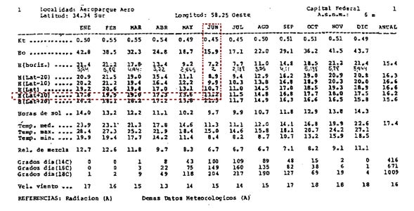

Next is our Kilowatt or Megajoule thing.
Here we have (take a look at the picture) a table with the average monthly energy on an angle of Lat+10º in MJ m^2 /day: 11,2
So we took this 11,2 and divide it by 3,6. This is 3,11 “equivalent hours” or “peak sun hours”. We are going to call them just “H” for HOURS.
This means that, if the sun where a full 1000 W lamp facing our modules, it will shine right above them for 3,11 hours straight. So if you take a look at the specifications of the modules, you will notice that they say: 80 W @ 1000 W m^2 – 25º C – 1,5 MA
That means: this particular module will produce 80 W when the sun gives 1000 W on each square meter at 25º Celsius and 1,5 mass of air.
But this is something you could investigate in further readings. For now, let's continue with the next step: Choose our module

H is the hours, we have seen this on the “Resource”.

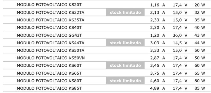

And Im is our new inquiry. Whis is nothing more than the current of our chosen module at standard test conditions (STC = 1000 W m^2 – 25º C, and so on).
So, here we could choose our desired module, and see what happens.
(1,2 x 16,5 Ah/day) / (3,11 H x 3,45 A) = 1,85
This means we are going to need 1,85 modules. Since this is a simplified calculation, we are just taking modules in parallels.
We are going to need 2 KS60T modules in parallel.
TIP: If the result is near 1,3 just keep 1. But if its more than 1,3 it is recommended to chose 2.

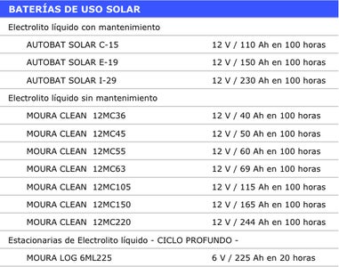

Step 5: Battery Bank
The battery bank is related to our cloudy days.
So you are going to need more research. Look for data on your weather service on a year basis. Usually 3 to 5 days are good numbers.
The formula here is like this:
Bb = (Iday x Cdays) / DoDWhere Bb is, battery bank
Iday, is as we have seen, again, our energy need.Cdays is our cloudy days.
And DoD is or “Depth of Discharge”
Here we have to talk to the battery manufacturer. Since each technology and kind of battery has an unique DoD.
We are talking here of 12 V batteries, to simplify. But you could form your bank from single-cell batteries, that are very powerfull.
For deep cycle, lead-acid batteries, a DoD of 0,7 is quite right. AGM is 0,5. look for specifications on the web.
So:
Bb = (16,5 Ah/day x 5 days) / 0,7 = > Bb = 117,86 Ah
I choose a 110 Ah /12 V AUTOBAT SOLAR Battery.
TIP: Remember, serial connections increments voltage, but maintains same current.Parallel connections maintains same voltage, but increments the current.
So, I could use two 12 V / 60 Ah batteries in parallel, or two 6 V / 110 Ah in series, and we always have the same energy. 12 V / 120 Ah in the first case, and 12 V / 110 Ah in the second.

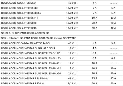

Step 6: Choose Your Regulator
The charge regulator has to manage all the currents involved on the circuit, and I would recommend to pick up one with at least:
• Reverse polarity protection.
• LVD, which stands for Low Voltage Disconnect. This will cut your energy on the load side if the battery is too low, and wont let you reconnect until is half charged.
• Battery type selection: Gel, AGM, sealed or classic lead acid.
• LEDs to check the state of charge.
Those are really basic features, and you have lots of regulators, with displays, remote controller and monitoring, USB connections.
Just don't get too picky, and choose one reliable, proved on the field.

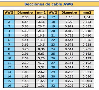

A small advice on connections:
The Universal technical standard recommends some cable diameters and voltage drops.
• For the Panel-to-Regulator length: 2,5 mm^2 (AWG 10) and 3% voltage drop.
• For the Regulator-to-Battery length: 4 mm^2 (AWG 6) and 1% voltage drop.
• For the Regulator-to-Load length: Just 5% voltage drop, and choose the wire that don't let the voltage go below that.
How to calculate voltage drop?
Well, if your system is 12 V, this is your 100%.
For 3%: (3 x 12 V) / 100 = 0,36 V
For 1%: (1 x 12 V) / 100 = 0,12 V
For 5%: (5 x 12 V) / 100 = 0,60 V

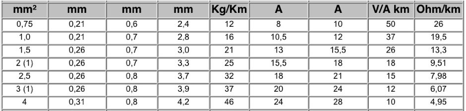

Now, you have to use this formula to test if your cable run is not too long or too thin.
V = 2 x Length (in meters) x Current (in amps) x Cable Resistance (on Ω/meters)
You probably have the resistance in Ω/Km. So divide that number by 1000.
So in each cable run, you have to make that calculation and check that the result is less than the spected V (1, 3 or 5 %).
For a run from panel to regulator of 4 meters, with 6,9 Amps (two 3,5 amps modules in parallel) and you whant a 0,36 V voltage drop tops, goes like this:
V = 2 x 4 m x 6,9 A x 0,0095 Ω/m = 0,52 V
As you can see, is above 0,36 V, so you will have to go to a thicker cable, since that is the resistance of 2,5 mm cable. Probably with 4mm will works.
