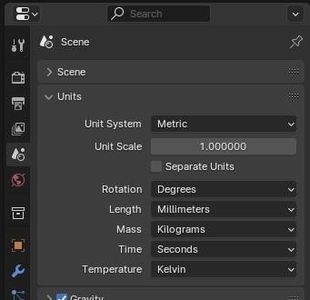

Open the latest free version of Blender from Blender.org and make sure its units are set to metric (mm) because that's what your 3d printer and slicer use. Remove whatever starting objects (default cube, camera, and point light) are in your project and then import all your SVG files.
The resulting objects are "curve" types. You need to convert the objects to meshes. Once you have, one by one select your layers and enter Edit mode. Select all the faces and Extrude them to your desired thickness. I knew that I wanted my coin to be around 50mm in diameter and less than 4mm thick. I resized all the objects so the coin ended up 47.6mm in diameter. I knew that my 3d printer was going to be set to print .2mm layer heights, so I made the thinnest layer 1.2mm thick, the next layer 2.8mm thick, and the designs 3.6mm thick. (Each of the thinner layers are moved upward in the Z axis to rest at the midpoint.)
