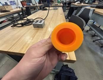

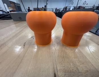

Step 4: Print Bulbs and Hooks
make sure parts are in correct rotation and have the necessary scaffolding to print

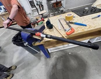

Step 11: Take Cooled Pipe and Hammer Out Rod
This step requires you to attach the rod to a vice and I would recommend slightly reheating the pipe for a higher chance of it all coming out in one piece, then you may remove both lids and with a elongated ob

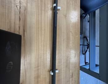

Step 12: Assemble
attach bulbs and curtain together by sliding the bulbs on, then attach hooks to window seal ledge, VERY IMPORTANT, the hooks made may not be able to be DRILLED into, I designed them this way to be mounted using adhesive strips to attach the hooks to the wall side as I can't drill into my walls, if you wish to drill into the walls I would add a pre determined hole fit for your choice of screw so the hooks don't shatter. or make the hooks out of a different material, I believe wood could work nicely.
