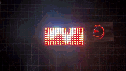

So here's something extraordinary, a custom Matrix entirely made from scratch.
This Instructables is about the whole built process of this matrix and its use.

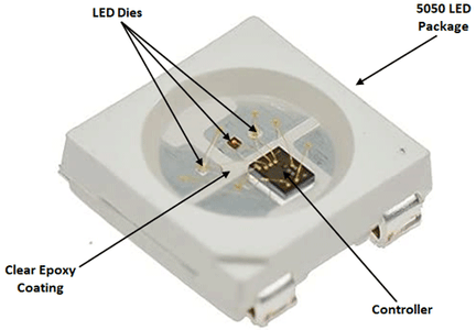

Step 2: WS2812B
WS2812B is an intelligent control LED light source that the control circuit and RGB chips are integrated into a package of 5050 components. It internal includes an intelligent digital port data latch and signal reshaping amplification drive circuit
The data transfer protocol uses a single NZR communication mode. After the pixel power-on reset, the DIN port receives data from the controller, the first pixel collects initial 24bit data and then sent to the internal data latch, and the other data which reshaping by the internal signal reshaping amplification circuit sent to the next cascade pixel through the DO port.
Its operating voltage is between +3.5~+5.3V DC.

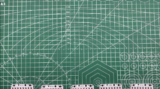

After finalizing the PCB and generating the Gerber data, PCBs were sent it to SEEED STUDIO for samples.
Order was placed for White Soldermask with Black Silkscreen and PCBs arrived in less than a week which was super fast.
The quality was super good considering the rate which was also pretty low.

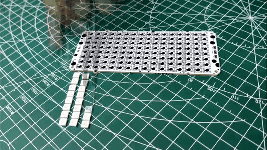

Step 6: SOLDER PASTE DISPENSING
We first apply solder paste to each component Pad one by one.
This Project uses WS2812B LEDs that has four Pads each, 128 LEDs were used so we need to apply solder paste to 512 Pads.
Instead of doing this manually, a stencil could be used here instead.

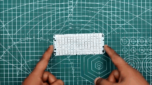

Step 7: Pick and Place Process
Next, we pick 128 LEDs and place them one by one in their assigned place.
Make sure to check the LED alignment and orientation as placing them correctly is crucial.

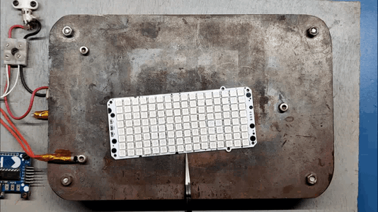

Step 8: HOTPLATE REFLOW
After the "Pick & Place Process", I carefully lifted the whole circuit board and place it on my DIY SMT Hotplate.
the hotplate heats the PCB from below up to the solder paste melting temp, as soon as the PCB reaches that temp, the solder paste melts and all the components get soldered to their pads, we lift the PCB and then place it on a cooler surface for a little bit, to cool down the heat of PCB.

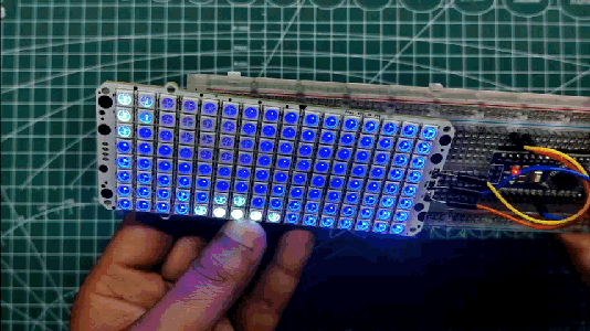

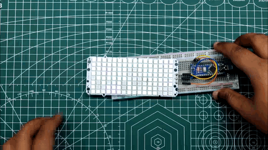

Step 9: Arduino Nano Connection
To Drive the Matrix board, we need to connect an Arduino Nano to the matrix by following the above wiring Diagram.
  • VCC of Matrix will get connected to 5V of Nano
  • GND to GND
  • Din of Matrix to D9 (any PWM Pin)

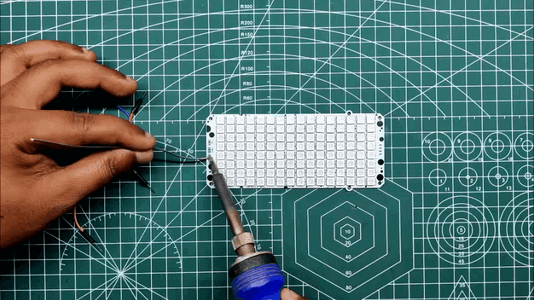

We Solder Jumper Wires directly with VCC, Din, and GND pins of Matrix so we can connect Matrix with Arduino Nano through a breadboard.

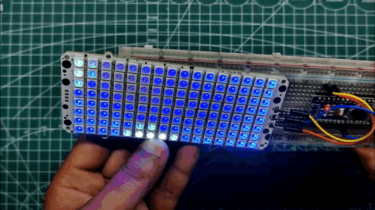

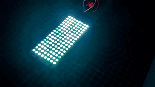

Step 10: Library and Example Sketch
For using this board, we can utilize a bunch of existing Libraries but we will focus on FASTLED LIBRARY for now.
The FASTLED is a library used for controlling a wide variety of LED chipsets, like the ones sold by adafruit (Neopixel, DotStar, LPD8806), Sparkfun (WS2801), and aliexpress.
Here's its GitHub page and you first need to download and install the library in Arduino IDE. https://github.com/FastLED/FastLED
Here's the main sketch that we will use and it's called NoisePlusPalette which can be found in FASTLED Example Sketches.

Here are a few things that we need to change from the actual example sketch.
#define LED_PIN     9
#define BRIGHTNESS 96
#define LED_TYPE WS2811
#define COLOR_ORDER GRB
const uint8_t kMatrixWidth = 16;
const uint8_t kMatrixHeight = 8;
const bool kMatrixSerpentineLayout = false;
We change the LED_PIN according to the Pin we have connected.
Brightness can be controlled as well up to 0-255.
kMatrixWidth and Height need to be changed as well according to our matrix layout which is 16x8.
This is important, kMatrixSerpentineLayout needs to be set to false, as our Matrix is not in Serpentine layout.
