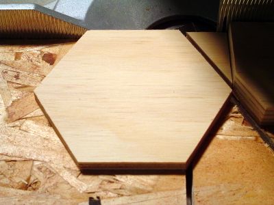

I thought this step would be easy. Rip your plywood to the right width, set the mitre saw to 30 degrees, and cut to a line. Hopeless. You'll end up with nice looking hexagons... but they won't be hexagonal enough that they tile nicely, and a board with gaps all over the place will look crappy. You absolutely must set the saw up so you cut to a stop.
First, cut your plywood to whatever width hexagon you want. I made mine 84 mm, slightly larger than the standard Catan tile. The strip of plywood then needs to be cut to lengths 2/sqrt3 longer than the width, i.e. 1.1547 x longer, so my rectangles ended up 84 x 97 mm. Cut to a stop, which you can clamp to the fence. Cut at least 19 pieces.
Angle your miter saw to 30 degrees; not 30.5 or 29.5, but exactly 30. Cut a bunch of test pieces, and fit together to ensure your angle is exact. Unless your saw is set up amazingly accurately, you'll have to nudge it about from what it reads on the gauge.
Mark the center, then set a stop so your angle cut precisely trims off a 30 deg triangle (see picture). Again, you'll have to fiddle a bit to get it exactly right - sub-millimeter accuracy is in order here.
Cut all the corners off against the stop. If you don't want the tiny triangle to go flying, wait for the saw to stop spinning before you lift it. Repeat process, trimming four triangles off each rectangle, at least 18 more times until you have 19 perfect hexagons.

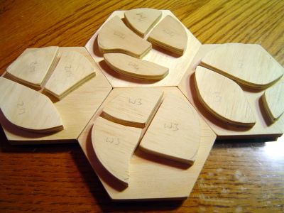

Glue the bits together using wood glue (yellow PVA). The pictures explain this better than I can in words; you'll end up with the 3D hexagonal tiles, as shown.

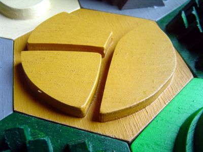

The wheat could just be a quartered circle.

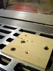

I wanted a circular base, so I roughly cut this out of the side of a plywood box; it happened to be 3/8" thick (9 mm). I then nibbled the outside off using my bench saw (see pictures), so that the circle was perfect. Then I sanded off the stickers, stopped the holes and smoothed the edges.

I used acrylic paints, the only part of the project that we had to buy. 118 ml tubes of Liquitex BASICS in neutral grey (ore), yellow oxide (wheat), light green (hills), cerulean blue (sea), Hooker's green (forest), red oxide (clay) and titanium white (mixed with a little yellow oxide for the desert and beaches). 3 coats. I got some expert advice to protect it with polyurethane, so I brushed on 2 coats of satin finish on all sides of board and tiles. It made the board look a little yellowed, but the effect was only noticeable on the beaches/desert.
