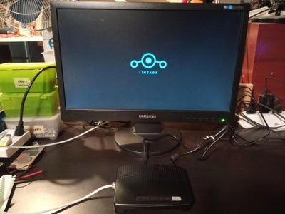

Step 6: Enjoy!
Note: if you connect the box on a TV with CEC feature, you can use your TV remote to control Android TV interface. You can also install the official Android TV remote app ( https://play.google.com/store/apps/details?id=com.google.android.tv.remote.service ) on your android phone, and use it as a remote.
