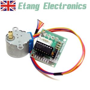

Step 3: The Wiring and the Motor.
So to fit everything in i needed to map the wiring as best i could. So...... The Arduino has a 2 LED array, a joystick module, the 5v stepper motor connected and is being powered by the Powerboost 500 connected to an old tablet Lipo battery.
The LED array runs two 10mm LED's with 1k resistors that can be turned on by two separate switches mounted at each end of the pickup run (my finger is on one of them) and once either switch is hit the LED's turn on and are bright enough to give of the effect of small flood lights which is really cool.
The Motor is a small stepper motor which is coded to run using the X axis of the joystick module. In the coding you can set how many steps the motor takes however i have coded for many more than needed to give my Brother-in-law the control over the motor and to stop it when it lights the LED's.

Motor:
http://www.ebay.co.uk/itm/141228411970?_trksid=p20...
