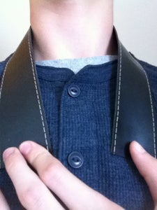

The next thing you'll need to do is figure out how much of the belt you want to use as padding. To do this I put the belt around my neck and left a few inches of belt on each side of my neck, then trimmed off the excess.
Step 5: Customizing the Neck Pad
Now that the belt or neck pad is at the length you like you can start customizing your strap. Get creative! Tool the leather, paint it, trim or round the corners, the possibilities are endless!
Step 6: Finishing the Neck Pad
The next you'll need to do is cut slots in the belt to thread the nylon strap through. The first thing you'll need to do in this step is measure the width(wide) of the widest buckle. Then measure inwards from the ends of the belt/neck pad about 3/4 inches and put a mark with your sharpie, then from that mark measure and mark the width of the widest buckle(the measurement taken earlier) on both sides of the belt/neck pad.
Once you marked the line on both sides you can proceed to cut a slot in the belt with your utility knife. And there you go! You're done the pad!
