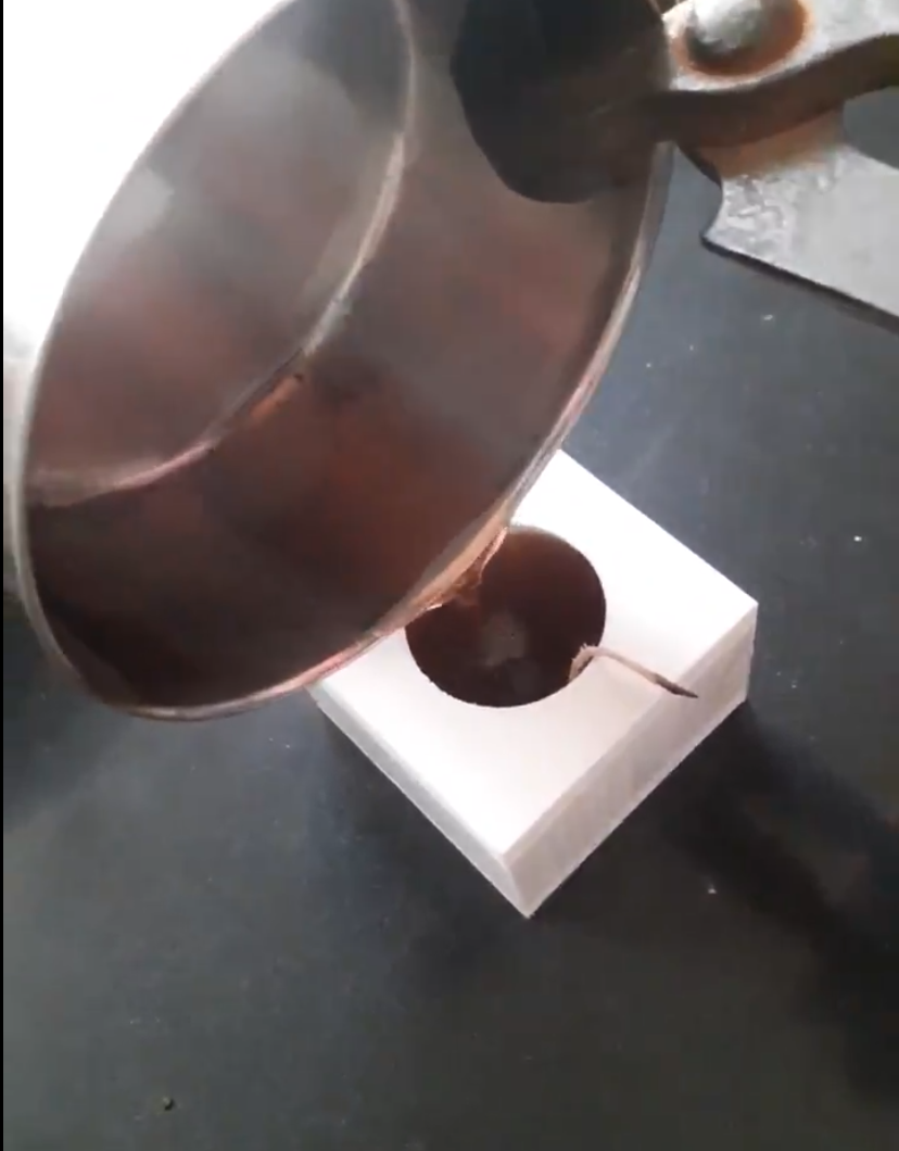

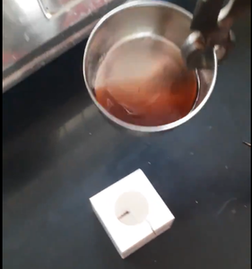

Step 6: Melting Wax & Pouring Into Mould
Use a small vessel to melt wax on the stove.
Start the stove and hold the vessel on the stove.

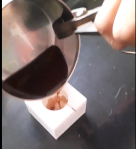

Wait to liquify all wax. Add a few drops of scent for a good smell while burning the candle. Bring mould and Pour Liquid wax Gently inside the mould.
Wait for 30 mint to cool down the wax. You can place the mould into a water container for cooldown.
Remove sellotape from mould and gently take apart both halves and remove wax parts.
Now you have your Candle ready to burn.
