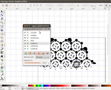

The Epilog laser cutters have good Corel Draw drivers, so I will show how to prepare PDF files to be used with Corel Draw.  Your laser cutter may prefer a different format.  I have included here the SVG source files - you should be able to use Inkscape to convert the SVG to whatever format you need.
If you don’t already have it, download Inkscape at http://inkscape.org. Inkscape is a free, Open Source software program for manipulating SVG files.
Open catan_board1_instructable.svg in Inkscape. Open the “Layers” tool by selecting “Layer->Layers…” from the menu. By clicking on the “eye” icons in the Layers tool, make only the following layers visible:
cuthexes
cutframe
cutports
Now select “File->Save As…” from the menu. With the dropdown box, change the file extension from “Inkscape SVG (*.svg)” to Portable Document Format (*.pdf)”. Then change the name to “board1_cut.pdf” and click Save.
Next, make only the following layers visible:
etch
etchframe
cutpips
Select “File->Save As…” like you did before and save this one as “board1_etchcut.pdf
Do the same steps with catan_board2_instructable.svg to create the files “board2_cut.pdf” and “board2_etchcut.pdf”.

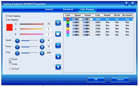

In Inkscape, open leather_instructable.svg. Then save it as a PDF file. When you open up the PDF in Corel Draw, you will see that there are two colors of vector, one large black rectangle and many green marks that trace out hexagons. The green hexagon marks are registration marks.  They help you line up the board to the backing during the gluing.
The black rectangle should be cut all the way through, and the green hexagon marks should only be burned in very lightly.
You can do this in the Epilog driver software by turning on Color Mapping.  (see photo)  Switch to the Color Mapping tab, enable Color Mapping with the checkbox, and edit the colors.  Select the first color, pull the R slider from 255 to 0, set the speed, power, and freq sliders to cut the backing, then click the Apply button ">>>".  Next, select the green color, and change the speed, power, and freq sliders to merely mark the surface of your backing and click the Apply button.
