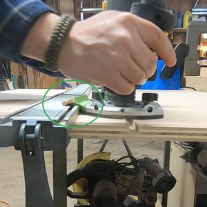

Step 3: Routing Dados
All of the shelves (cross pieces) will be attached to the side pieces with dados. Dados are just a fancy name for slots cut into wood. I used a router with a guide clamped in place to make the lines. I did both side pieces at the same time to ensure that the dados would be at the same heights on both pieces. You can refer to the image in the previous step for the location where I put my dados. That being said, you can customize and place shelves where ever works best for you.
Tip1: Add a sacrificial piece at the end of the dado to prevent tear out.
Tip2: If you don't have a router bit that is the right size (in my case I was making 3/4" dados and only had a 1/2" router bit) you can add a small piece of wood as a spacer (1/4" in my example) which will offset the router off of the guide. This allows you to make one pass along the guide, then add the spacer and make a second pass. This way you don't have to move the guide between passes.

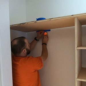

Step 6: Top Shelf Cleats
The top shelf is just a single piece of plywood cut to fit the space (18"x92"). In order to support it I added cleats (which happened to be cut offs from the previous step). I used a stud finder to locate the studs (tip: mark the studs on masking tape so that it can be easily removed afterwards). I then transferred the location of the studs to the cleats. I drilled and added a countersink to match the locations of the studs.
I screwed the cleats to the wall and used a spirit level to ensure the top shelf would be level.

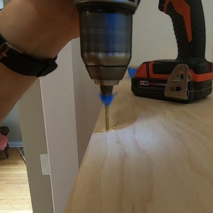

Step 7: Attaching the Top Shelf
To attach the top shelf to the cleats and the shelving unit I wanted to use screws. I first drilled pilot holes, then used a countersinking bit to add a countersink. Lastly I screwed it in using 1 1/4" wood screws.

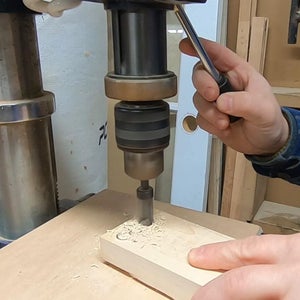

Step 8: Plugging the Screw Holes
As screw holes are not very nice to look at I decided to add plugs. I used a plug cutter to cut some plugs in some scrap maple. I used my bandsaw to cut them out, but you can also just pry on them with a screwdriver.
I added glue and hammered them in place with a mallet.
After the glue was dry I cut them flush with a flush cut handsaw.

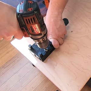

The shelf piece first got three holes drilled into it using my milescraft dowel drill guide. This guide ensures that the drill bit is centered and that it is drilling perpendicular to the work piece.
I then slid the shelf piece into the dado and added dowel centers to the holes I had just drilled. Dowel centers are used to transfer the location of the drilled holes to another piece of wood. I slid the upright piece in place and ensured that the shelf was square. To transfer the marks from the dowel centers I just simply tapped on the upright piece.
I then drilled the holes in the upright piece. I again used the milescraft dowel drill guide to ensure I drilled perpendicular to the surface. I used a brad point bit which made it very easy to align with the marks from the dowel centers.

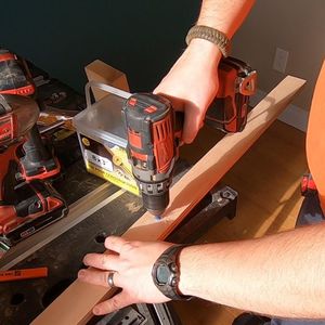

To assemble this extra shelf I first started by adding glue to the dowels and putting them in place. I then added glue to the edges of the shelf piece. I slid it all together and clamped it in place.
To ensure the upright didn't end up moving I added some screws. I drilled, countersunk and added 1 1/4" wood screws. As it wasn't a structural piece, I only added two screws.
