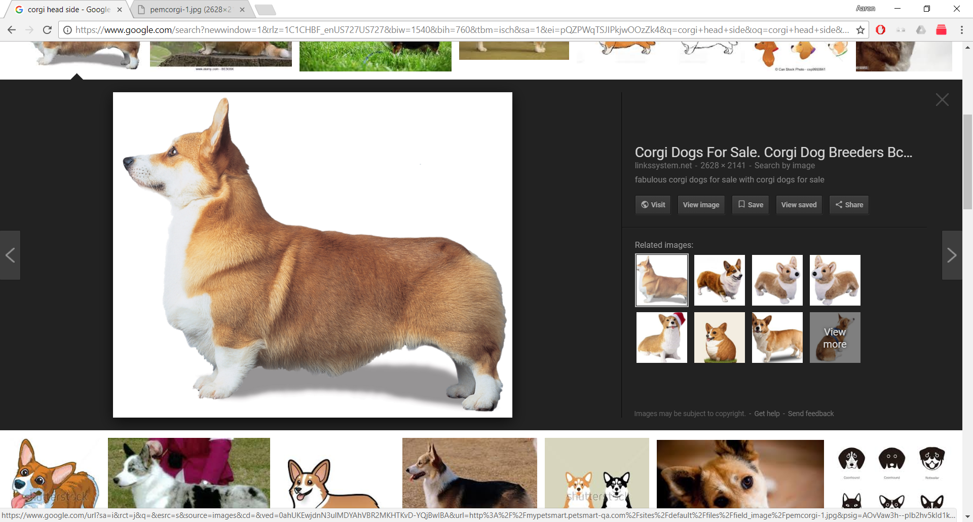

Possibilities are endless when it comes to choosing a pattern to cut. In this instructable I'll show you how to make a cutting pattern from almost any image on google. Preferably one with a white background. If you want to skip straight to the cutting without worrying about making a custom pattern, check out the final step where you will find some premade patterns.
If you found a silhouette online that suits your needs:
- Import the silhouette to Photoshop
- Skip to the step where the elliptical marquee tool is used to crop the silhouette
- Proceed through the steps to resize the image and print it out (I recommend printing out multiple copies of the pattern in case you make a mistake and need to start again)

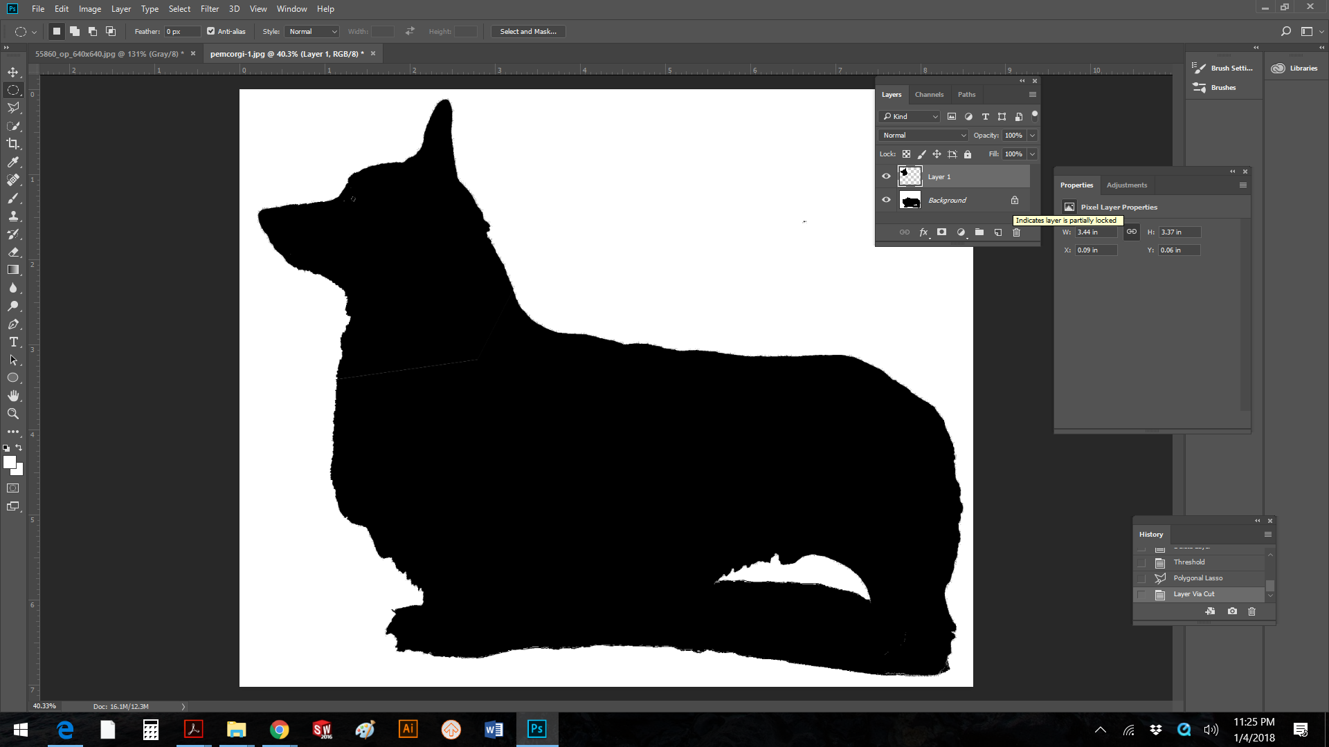

Now, import the photo into Adobe Photoshop, or any other image editing software of choice (Gimp, Inkscape, MS Paint, even PowerPoint works for this project). The idea is to silhouette the image so that we have a solid border to cut along when we print out the pattern.

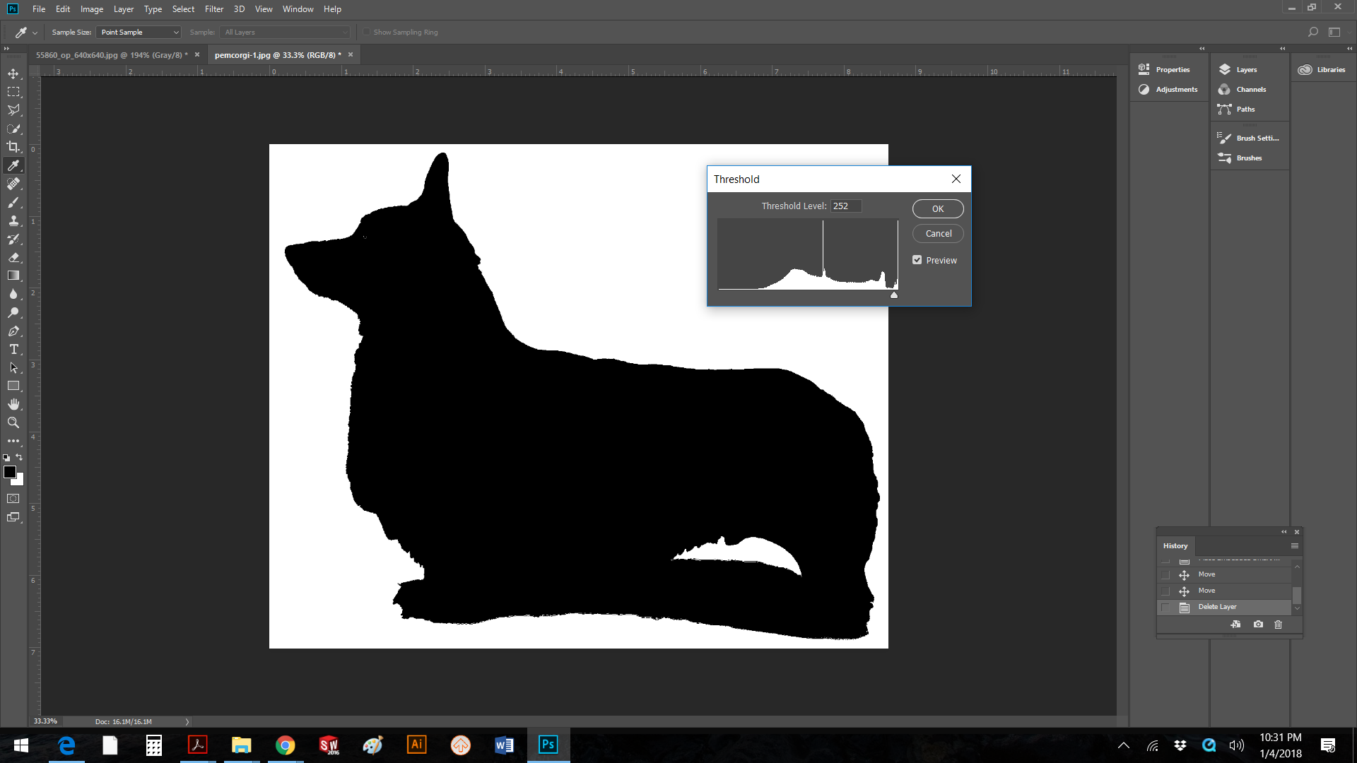

To silhouette the image adjust the threshold of the image until it is a solid silhouette:
top menu > image > adjustments > threshold

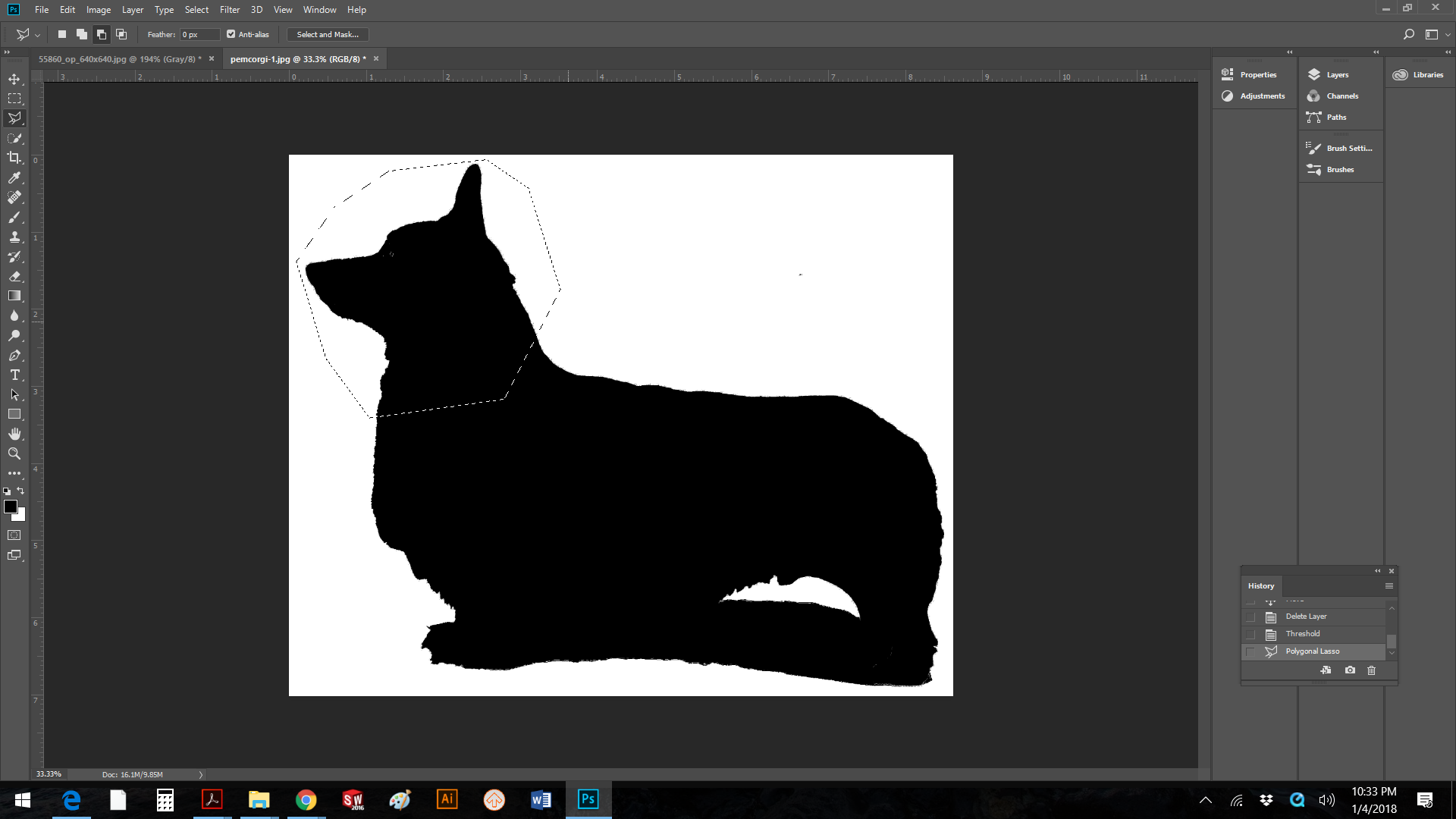

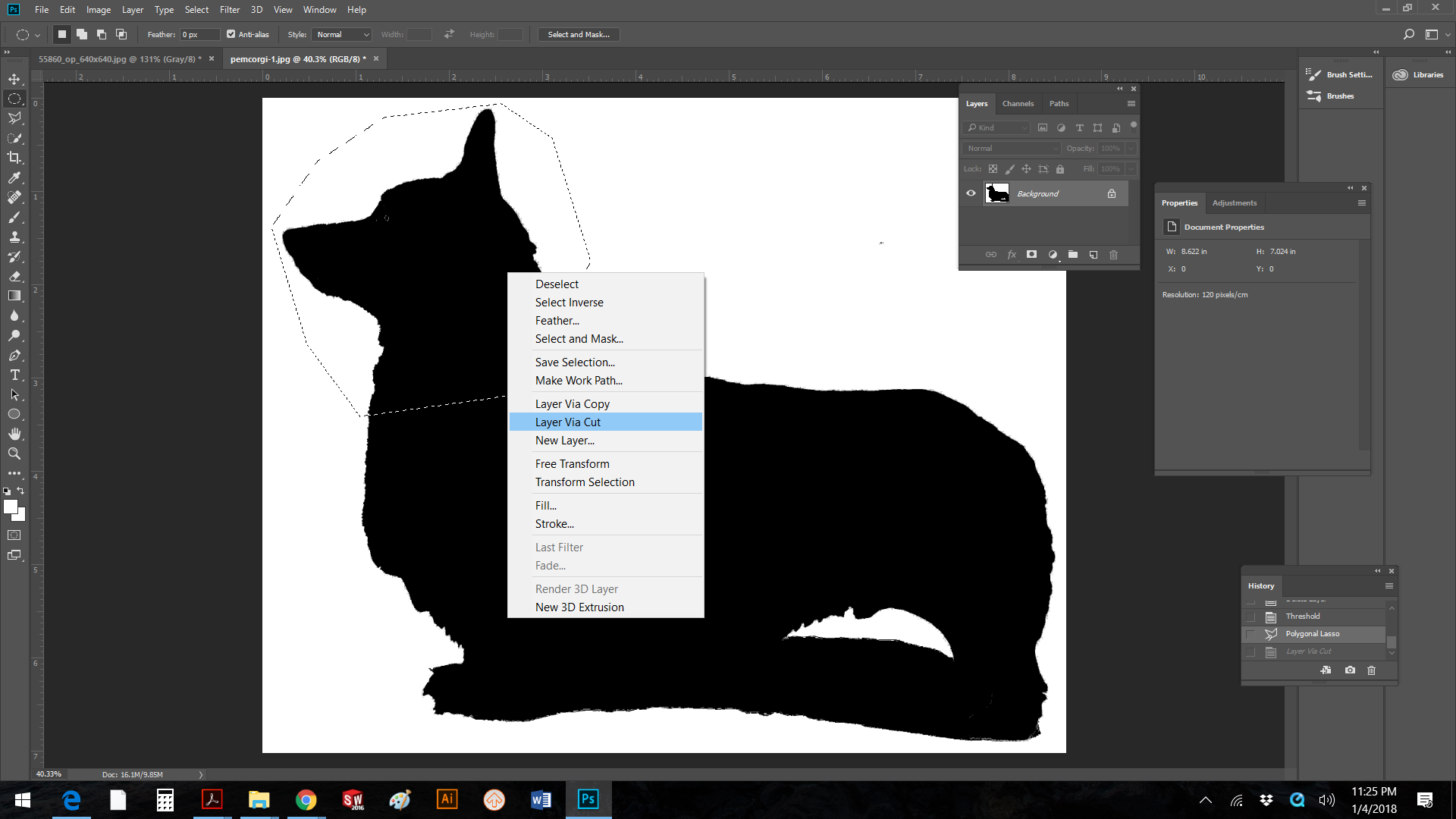

Pick a notable part of your silhouette to pattern. In this case I want to make a necklace of the dog's head, so I will use any of the three Lasso tools to cutout the head.
toolbar > lasso > polygon lasso tool

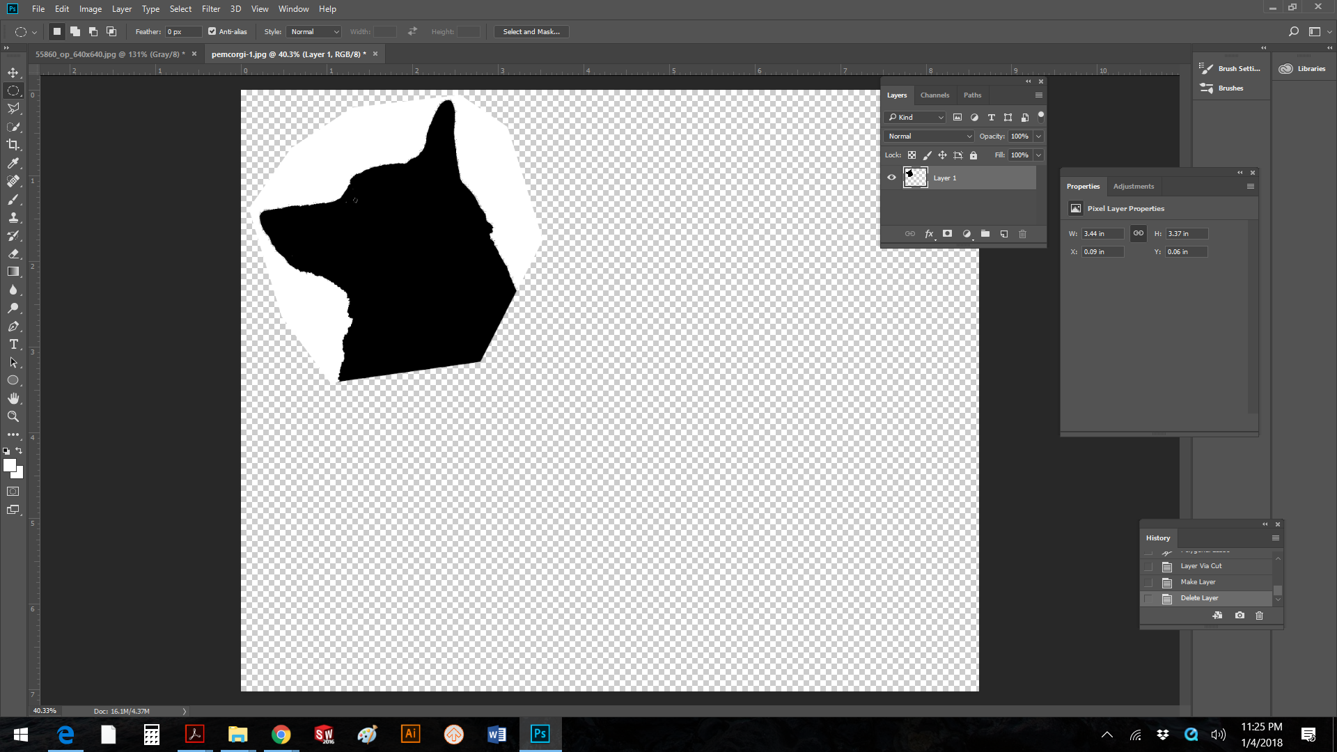

Next, we need to isolate our selected region. To do this:
right click on region whilst still using the lasso tool > new layer via cut
You will notice that a new layer has been created in the "layers" window. If you don't see the layers window:
top menu > window > layers

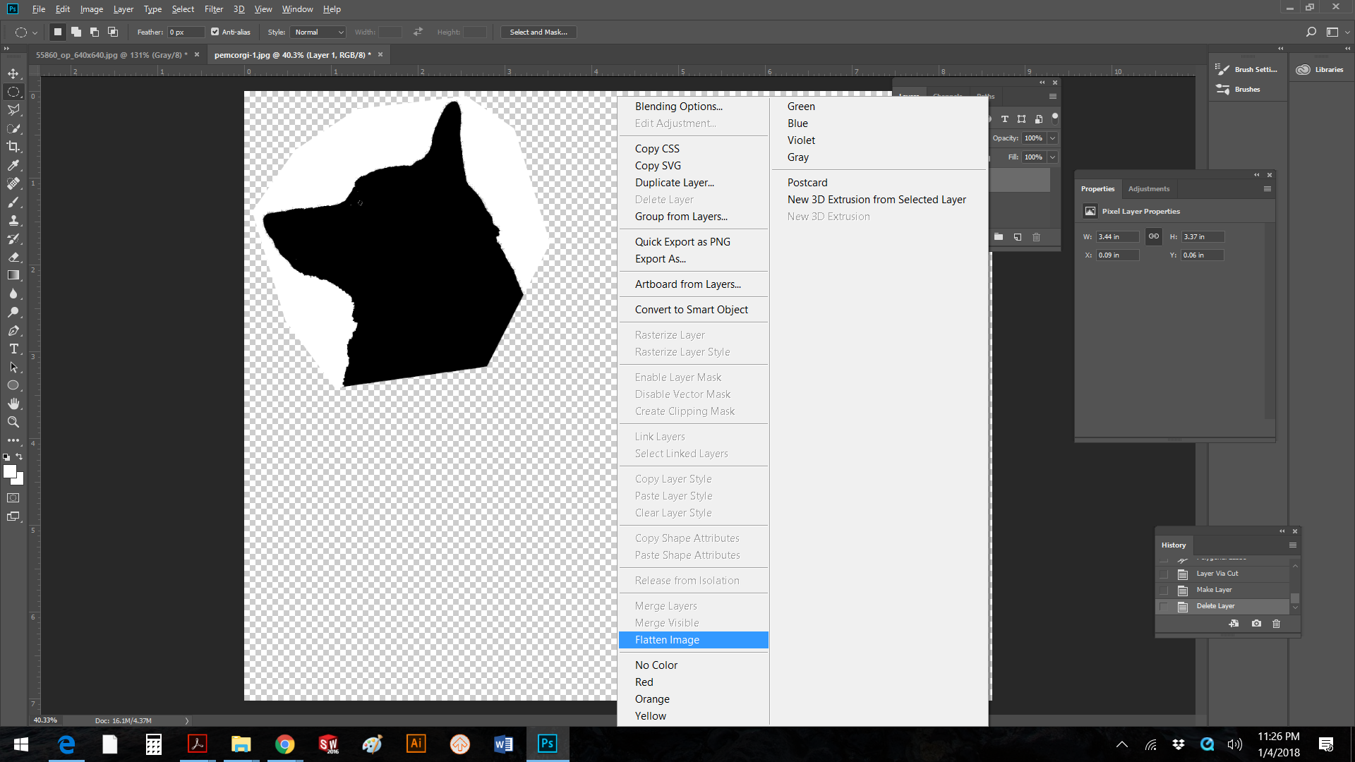

To delete everything but the selected region, we need to delete the background layer. To do this, unlock the background by clicking on the lock icon in the layers window. Then hit delete.
Right now, the isolated region is just "floating in space." In order to tell Photoshop we want to keep this region:
right click on the layer in the layers window > Flatten layer

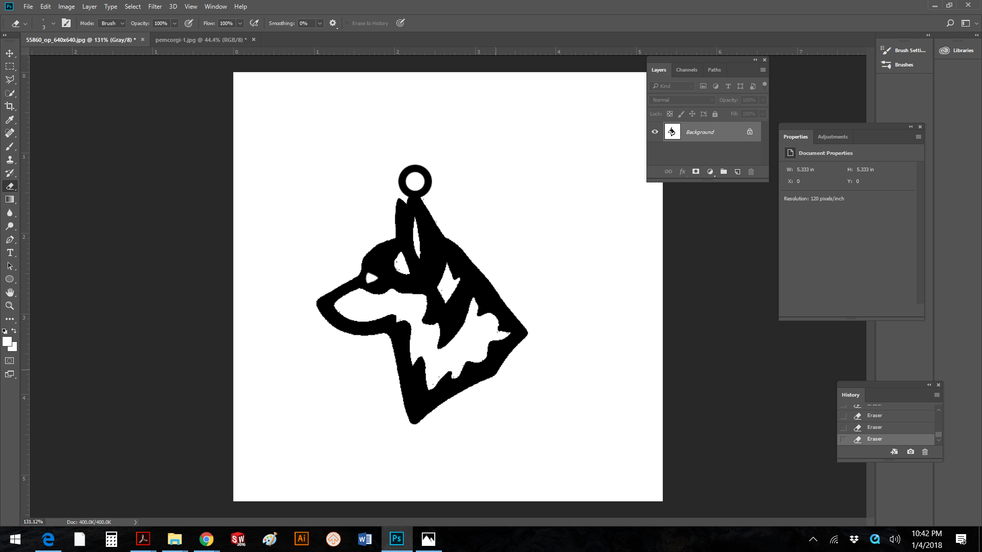

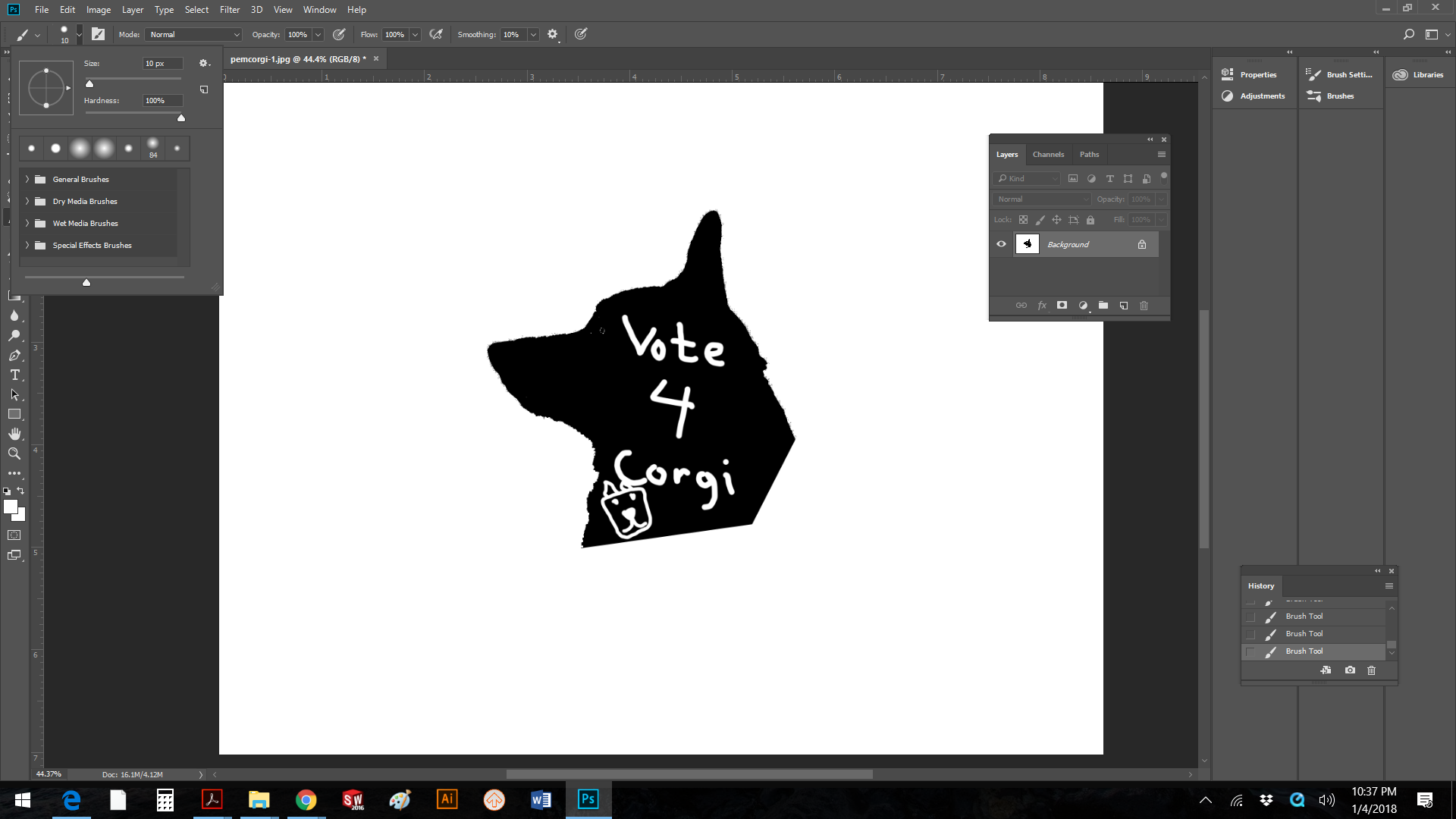

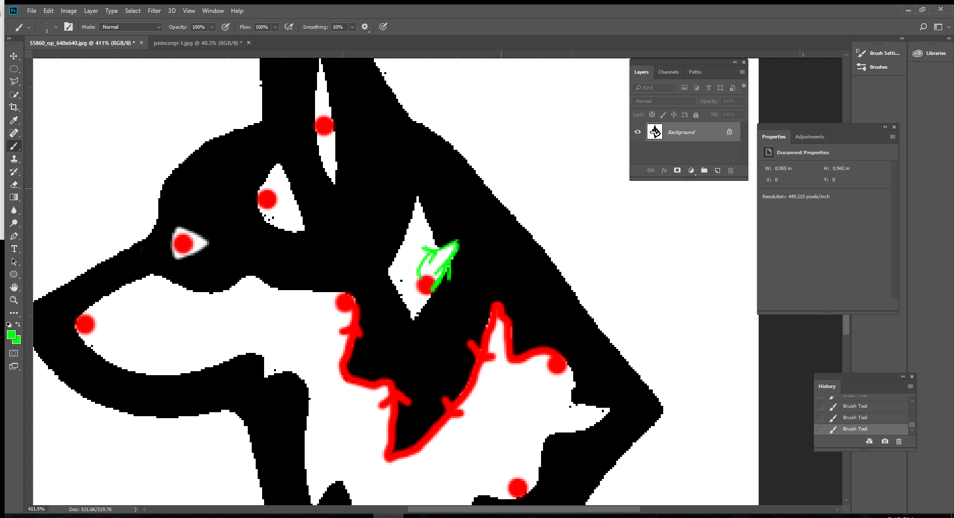

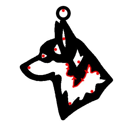

This pattern is enough to get started with. To take this project to the next level, you can consider cutting out different cavities within the solid as well as refining the contours of the pattern using the brush tools:
toolbar > brushes > Brush tool
To change the color of the brush to white (if it isn't already white)
hold Alt Key + click in a white area to "copy" the color into the clipboard
When drawing internal cavities, consider having a smooth contour without sharp kinks and corners (sharp corners are difficult to cut around without the risk of twist snapping the blade which may get caught in the corner).
Pro-tip, ensure that the corner radius is at minimum, equal to the "diameter" of the saw blade). I won't bore you with the details of refining contours and drawing cavities, but this is the final pattern I came up with (for download at the end of this instructable):

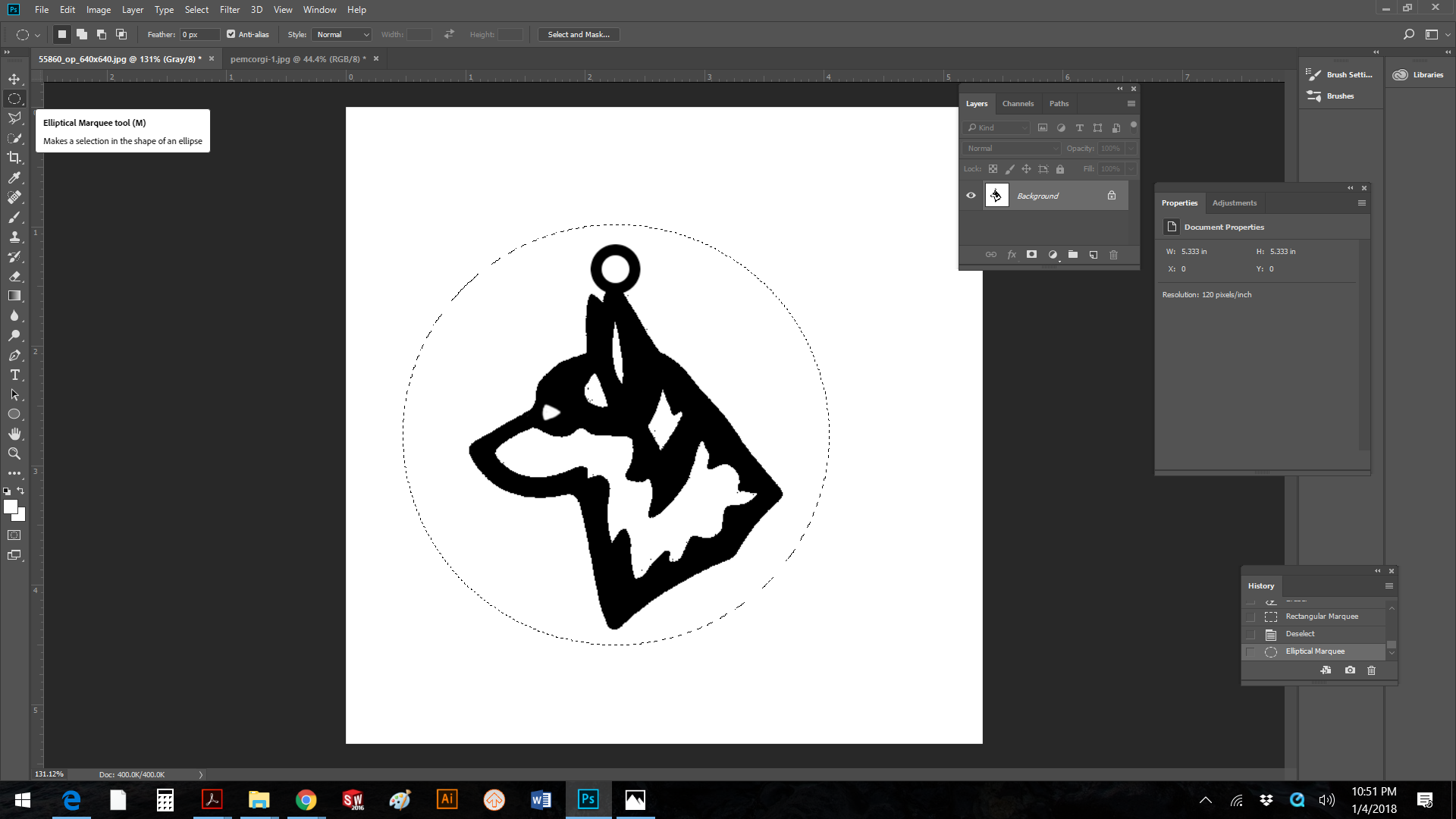

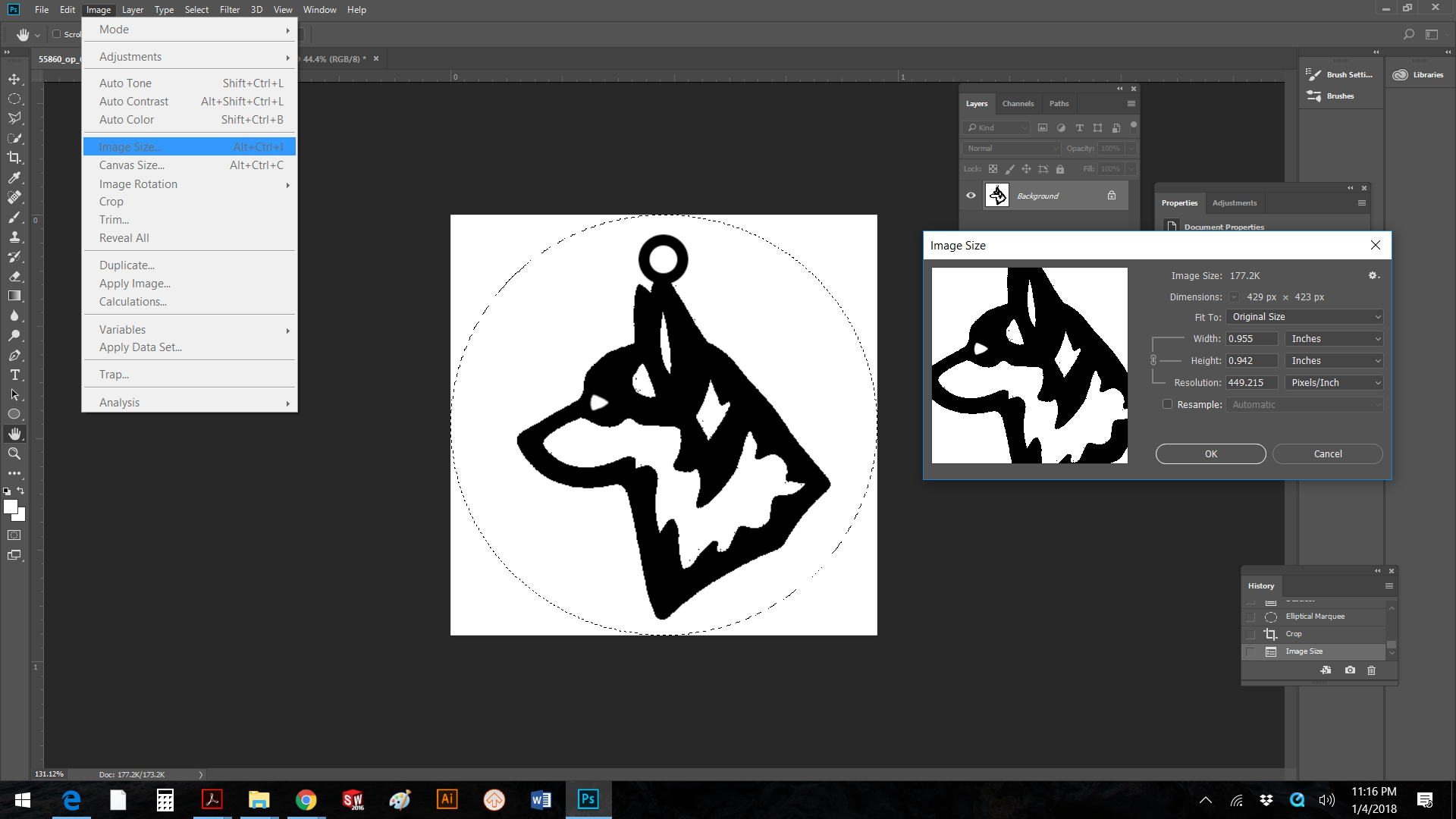

Now we need to resize this image so that it prints to the correct size (the size of a quarter, or another coin). The diameter of a quarter is 0.955 inches, so this is what we will use. First, using the elliptical marquee tool, draw a circle around your pattern -- centering the pattern with the top and bottom edge just contacting the edges of the circle
Toolbar > marquee > elliptical marquee tool
to crop the current artboard to the size of the pattern:
top menu > image > crop
this will crop out everything, leaving the enclosed region of the circle:
We now size the image to fit within the edges of a quarter with diameter 0.955 inches:
top menu > image > image size
Input 0.955 inches into both the height or width boxes -- ensuring the chain link is broken to break the aspect ratio lock.

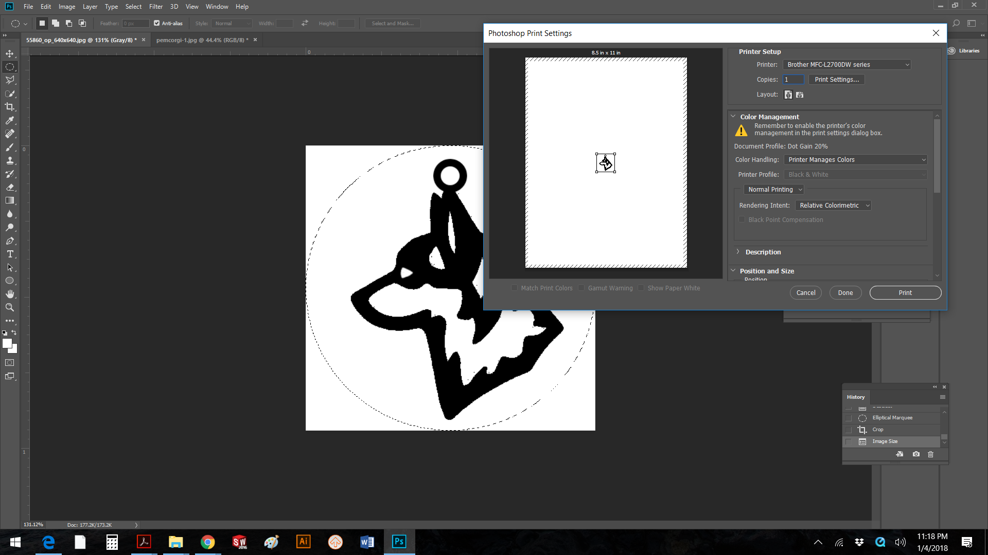

If you're using Photoshop, you can print directly:
top menu > file> print
Double check to see that the pattern size small relative to the letter sized paper. Doing this ball park check, will prevent you from accidentally wasting ink on a full sized pattern.

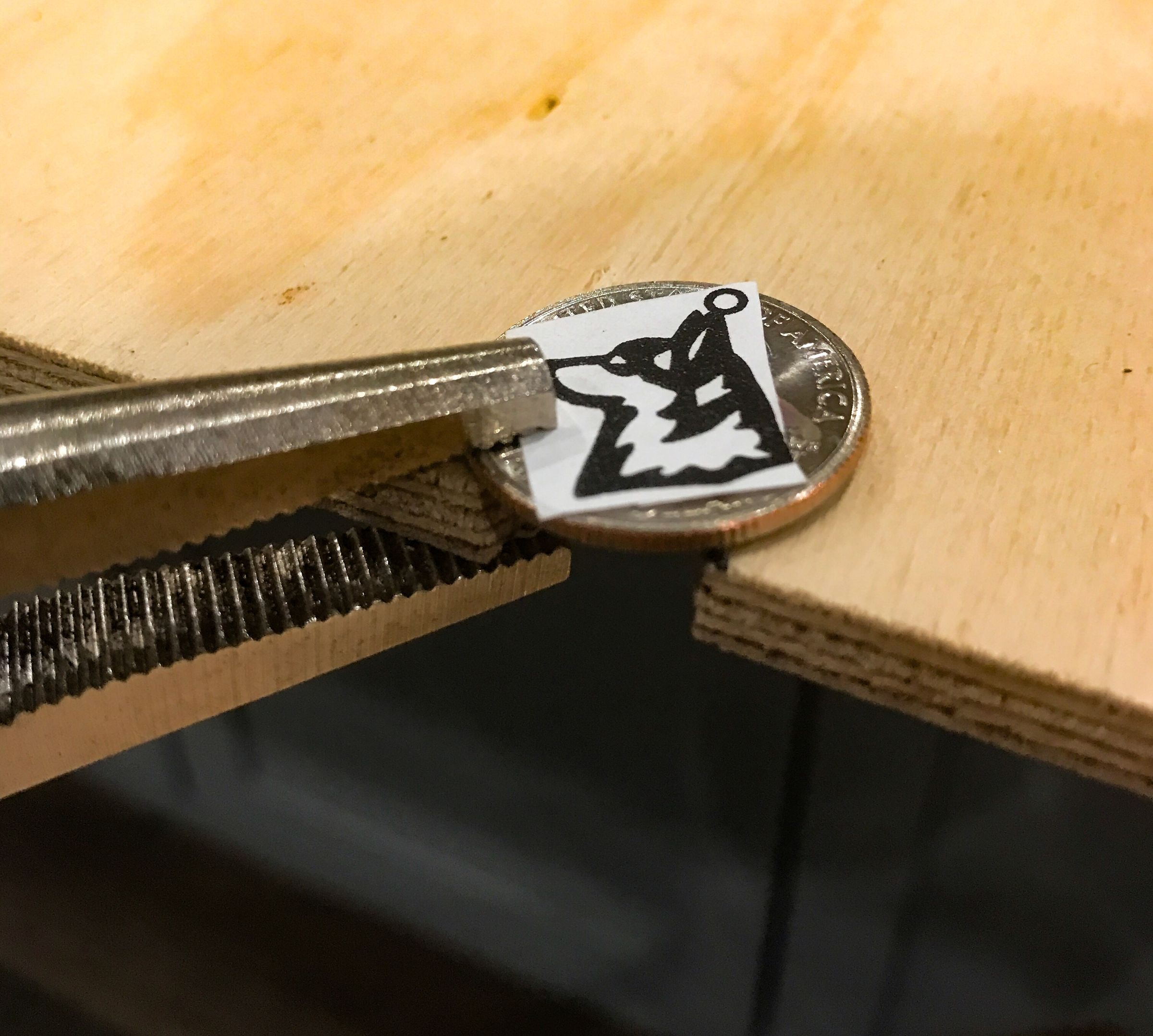

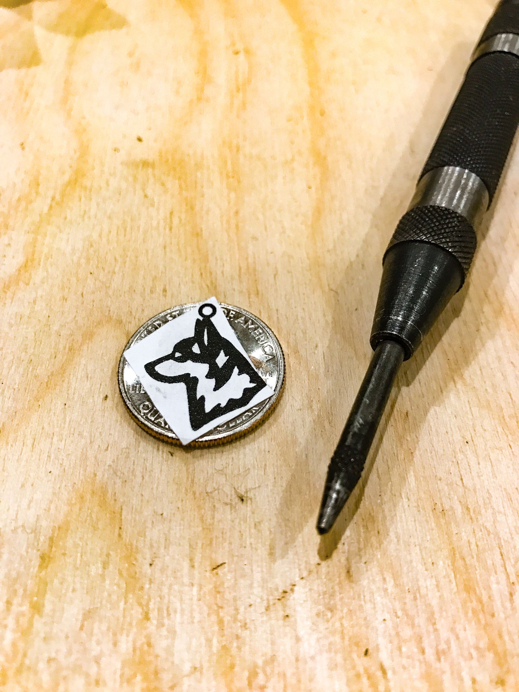

It's time to overlay our pattern on the coin. First, cutout the pattern. It doesn't need to be a clean cut, as excess paper surrounding the pattern will give the pattern more surface area to stick to the coin. Apply a liberal amount of stick glue and quickly dry it with a heat gun or a blow dryer. As the glue dries and contracts, it pulls the paper tightly against the coin, which helps the paper from peeling off due to the oscillatory motion of the saw that is to follow.

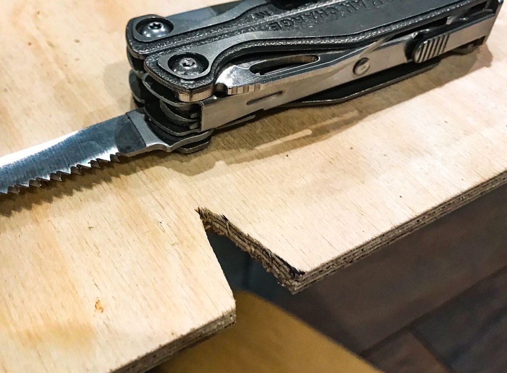

Next, cut a "V" notch about an inch long and half an inch wide on the edge of a wooden board. The board can be anywhere from 1/4"-1" ideally. The purpose of this notch is to give the sawblade room to move while still giving the craftsman a supporting platform to hold down the coin.

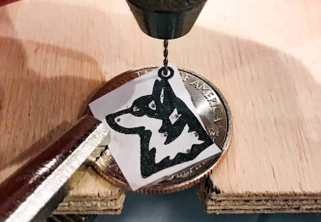

Now, clamp down the coin over the V-notch with a pair of vise grips. We'll need to drill small holes in the coin where the cavities will eventually be cut out. These holes are necessary for the saw blade to be threaded through. Below is a diagram with hypothetical drill points depicted by red dots
Drilling Tips:
- DO Use very light pressure when drilling metal coins.
- DON'T Push too hard. This can over torque the bit and snap it in half. DO handle this drill bit as you would a piece of 0.5 pencil lead.
- Use a center punch to make a pilot hole. This will prevent the drill bit from wandering around the surface of the coin.
- After you drill through, DO remain calm. Pulling the drill bit back out is often when it breaks. Slowly pull the drill bit back out, perpendicularly to the face of the coin. Do this while the dremel is still on to reduce the friction between the hole and the bit.
Below, you can see some holes drilled where the cavities would later be cut out. It doesn't hurt to drill extra holes. DO remember to prolong the life of your drill bit with cutting oil. Broken drill bits = frustration (Trust me!)

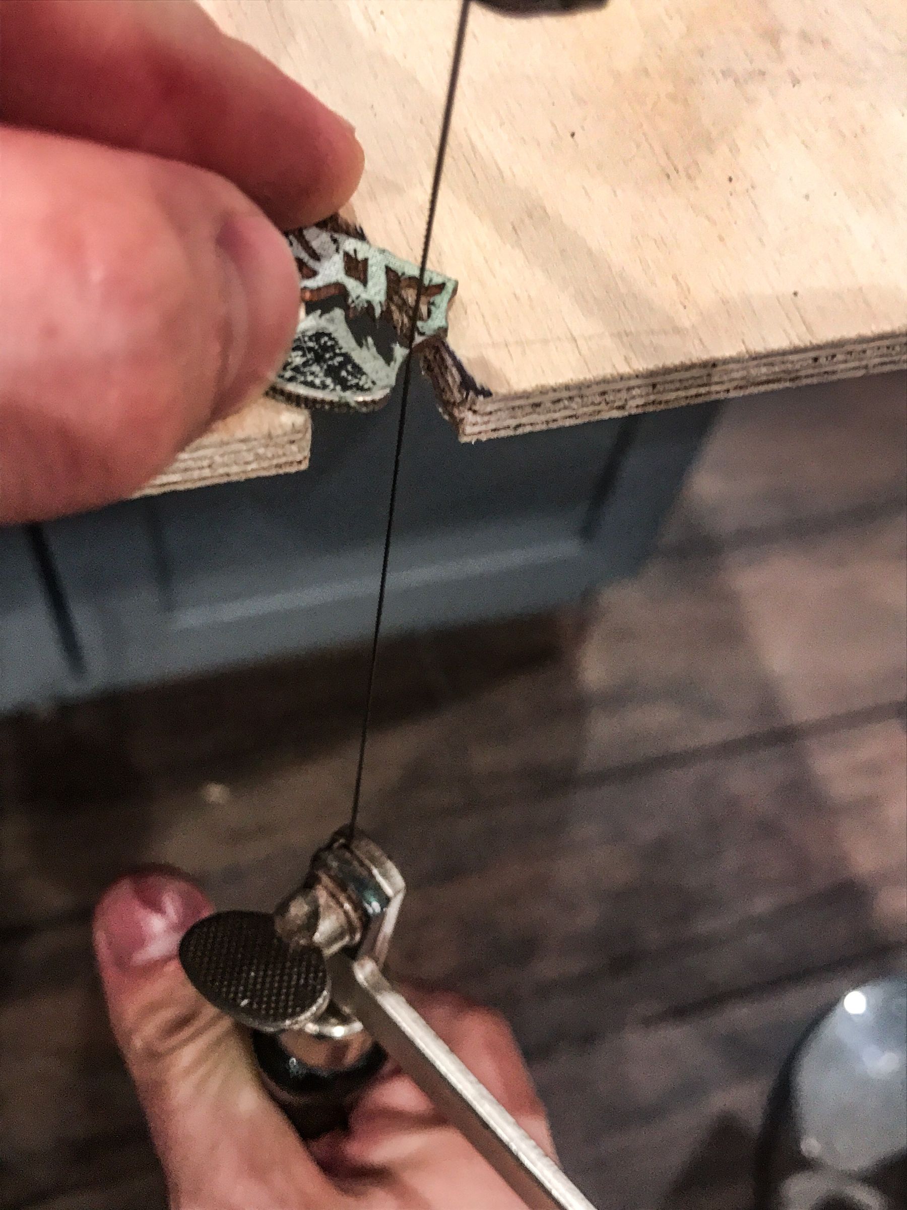

Next, feed the hair-thin saw blade through the hole. Reattaching the ends of the saw blade to the saw. I forgot to document this step before cutting part of the coin, but the following should get the point across.
To learn how to use a jewelers saw, refer to this instructable. It goes into detail about how to use the "V" notch base, as well as proper blade mounting. Essentially, we want the blade teeth to be facing down so that the cutting stroke is a pull downward with gravity. This makes for a smoother cut and less likely to snap the thin blade.
Now you may begin to cut along the inside edge of the cavities. A diagram below depicts one potential route to take, when cutting out all the cavities.
When starting a cut from a pilot hole, remember that you don't need to make one continuous perimeter cut. You can make a cut, return to the pilot, and begin a cut in a different direction. Below are diagrams to demonstrate this:
The latter cutting approach takes slightly more time but is easier to do and reduces the chance of breaking a blade while taking a corner. The latter approach keeps the blade traveling in a straight/semi-straight trajectory -- reducing torsional load on the blade. As you cut and travel along a curved trajectory, lift and turn the coin to reposition it on the V-notch.

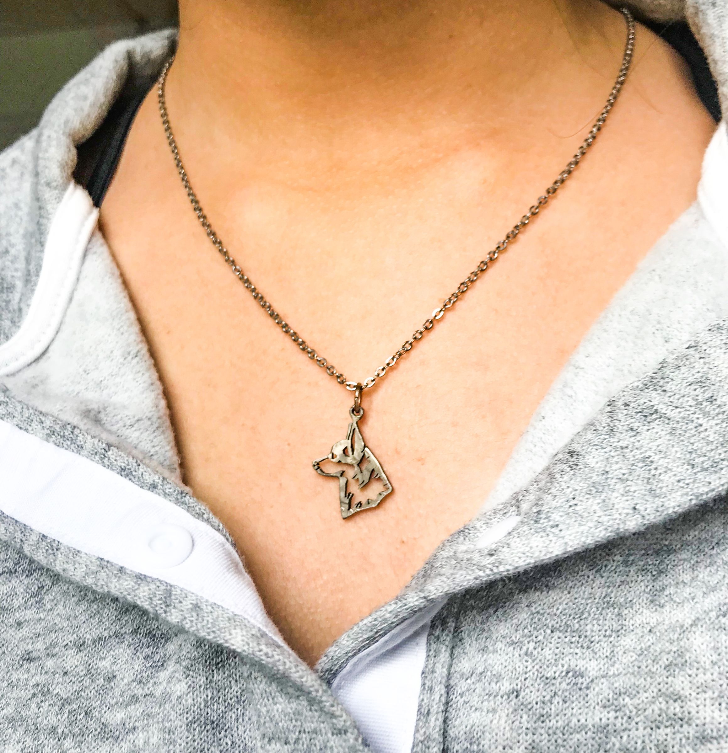

Once you're satisfied with your work, you can link it to a necklace chain with a ring. I typically use 6 mm rings because they're large enough to have some play when looped around the chain, but also small enough to not outshine the pendant itself.
VOILA! You just made a one of a kind necklace! (Aside from the one I made). Feel free to use any of the patterns I provided. If you have any questions, let me know where you're stuck in the comments below! I appreciate all of the feedback!
