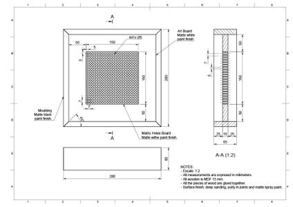

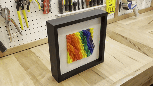

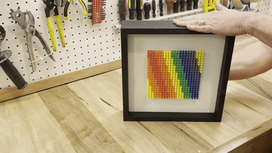

Step 1: Design
The design is very simple.
I did plans using fusion 360 (https://www.autodesk.com)
All the wooden parts are made of 15 mm MDF.
The size of the finished work is 28 cm x 28 cm x 6,5 cm (width x length x depth)
The mouldings are 1,5 cm x 6,5 cm with a 45 degree bevel finish.
The board where the artwork goes is 25 cm x 25 cm. It has a central part that is a 15 x 15 cm matrix with 441 Ø5 holes located equidistantly (21 rows x 21 columns).
How does it work?
The holes in the matrix allow the colored plastic pieces to be inserted one by one following a predefined pattern (see step 5)
They are 441 plastic pieces Ø4 x 65 mm with the colors of the rainbow: red, orange, yellow, green, blue and purple.
From the back, if the pins are pressed with an object or by hand, they move forward, taking the artwork dimension and shape on his front.
If you want to re-level the plastic pieces, simply lay the artwork flat with the front facing up.
The attractiveness of the design is that you can play creating other figures and shapes of your choice, and also make variations with the relief of the work of art, accommodating the position of the plastic pegs.

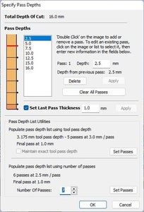

c) Matrix Holes Cut:
- This is a key step in the whole job. The exact dimension of the holes and their quality are really important.
- Cut 1 square 18 cm x 18 cm with 15 mm MDF.
- Position the wood in a CNC to make a matrix of 441 holes (21 rows x 21 columns) and a final external dimension of 15 cm x 15 cm.
- I used a 1/8” Shank Spiral Upcut Router Bit.
- I used Vector Aspire software to create the g-code file. I attach the file in DXF format to import the vector in your in your favorite cnc cutting software.
- Parameters I used in my CNC:
  • Holes: spindle speed 6000 rpm / feed rate 100 mm/min / plunge rate 50 mm/min - Use option "Add ramps to toolpath" that allows the hole to be built with the cutting tool in the form of a helicoid.
  • Perimeter: spindle speed 6000 rpm / feed rate 300 mm/min / plunge rate 100 mm/min.

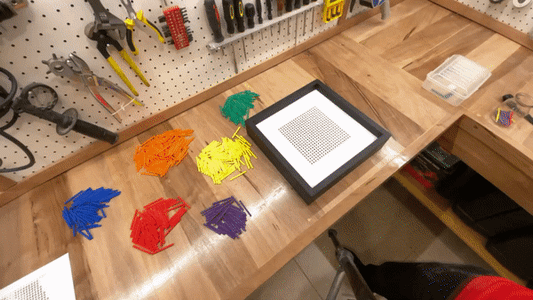

Step 4: Printing Plastic Parts
The original 441-piece plastic design in this instructable (see step 5) consists of:
  • Red pieces quantity= 63
  • Orange pieces quantity= 109
  • Green pieces quantity =63
  • Yellow pieces quantity= 98
  • Blue pieces quantity= 63
  • Purple pieces quantity=45
In this step, have a lot of patience for printing because there are many plastic pieces with different colors.
With the attached STL files you can export to the program you use to define the printing parameters (CURA, etc.) and export to GCODE:
The print was made with PLA filament on a 3d printer.
The main parameters that I used were:
  • Layer Height = 0.16 mm.
  • Infill = 20%
  • Bed temperature = 60 degrees.
  • Nozzle temperature = 200 degrees.
  • Printing speed = 50 mm / min.
  • Generate support = no
Due to the small diameter of the plastic piece, when printing (I have an Ender 3 Pro printer) you will probably have to do tests adjusting the scale of the object so that the dimension after printing is exact. In my case I had to multiply the object in width and length by a factor 1,10. Do tests with your printer before starting all the printing
Once the parts are printed, use fine sandpaper or tweezers to remove any damage or printing failure on the plastic parts. They must be able to slide perfectly into the holes of the Art Matrix Holes.
The STL file is attached so that you can use any program like CURA or similar to export to g-code.
I placed the pieces vertically, printing up to 12 units of the same color at the same time.
Due to how the pieces are placed on the bed (vertical position), it is very important that there is adherence to prevent the pieces from falling off, and causing a mess to the entire assembly you are printing. I used his preferred method, in my case I used hairspray. It is also very important to regulate the retraction to avoid the formation of small threads that can also cause problems when printing (apart from natural printing defects).

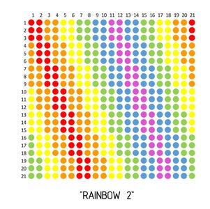

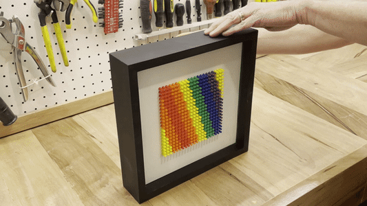

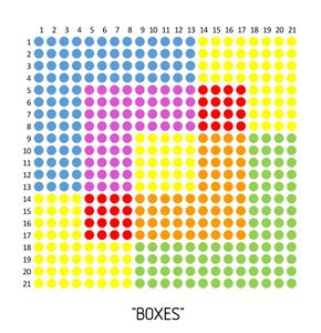

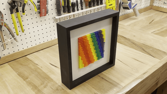

Step 5: Plastic Parts Assembly and Use
This was one of my favorite parts, it consists of placing each of the plastic pieces following the attached pattern (Rainbow 1).
Alternatively, other proportions of plastic parts can be printed that allow other types of drawings to be made, such as the ones attached (see fotos knitting, indian, pacman, rainbow2, boxes).
The pieces have a small surface notch that allows them to enter up to a certain limit when introduced.
On the back of the box, if you press with an object or your hand on the grid of plastic pieces, the pieces will move forward.
To return to the starting point, you only have to put the assembly in a horizontal position.
I attach an Excel file here with all the designs, and the possibility that you build the one you like.

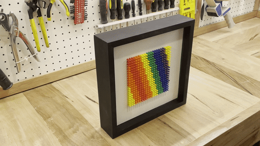

Step 6: Final Assembly and Enjoy
If you came to this place on the instructable and also built this piece of art, now is the time to fix it to the wall and enjoy the finished work:
- Choose a wall in your house to install it.
- In my case I made a hole in the wall and installed a fisher wall plug S5 (choose the right model for your type of wall). Height from the floor approximately 1.65 / 1.75 m.
- Then I put in a 2.5mm self drilling screw.
Alternatively it can be placed somewhere other than the wall, especially if you want to play around with changing the position of the plastic parts.
Surprise your family and friends with this peace of art built by yourself.
