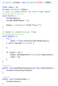

Here you can see the code used to connect to Arduino. At the start of the game I open a stream and I constantly wait for data from the Arduino. Based on this data I have to jump.
This also includes some methods used by other classed which can be used to send data to the Arduino, such as amount health.
The rest of the game is a simple endless runner which spawn obstacles which the player has to jump over.
