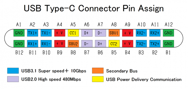

Step 5: USB C Interface
  1. A1------------------GND------------------------Ground return
  2. A2 -----------------SSTXp1 ("TX1+") -------SuperSpeed differential pair #1, transmit, positive
  3. A3 -----------------SSTXn1 ("TX1-") --------SuperSpeed differential pair #1, transmit, negative
  4. A4 -----------------VBUS ------------------------Bus power
  5. A5 -----------------CC1 -------------------------Configuration channel
  6. A6----------------- D+ ---------------------------USB 2.0 differential pair, position 1, positive
  7. A7 -----------------D− ---------------------------USB 2.0 differential pair, position 1, negative
  8. A8 ----------------SBU1 ------------------------Sideband use (SBU)
  9. A9 ----------------VBUS --------------------------Bus power
  10. A10 --------------SSRXn2 ("RX2-") ----------SuperSpeed differential pair #4, receive, negative
  11. A11 --------------SSRXp2 ("RX2+") ----------SuperSpeed differential pair #4, receive, positive
  12. A12 --------------GND ---------------------------Ground return
  1. B12 --------------GND ----------------------------Ground return
  2. B11 --------------SSRXp1 ("RX1+") ------------SuperSpeed differential pair #2, receive, positive
  3. B10 --------------SSRXn1 ("RX1-") -------------SuperSpeed differential pair #2, receive, negative
  4. B9 ----------------VBUS -----------------------------Bus power
  5. B8 ----------------SBU2 ----------------------------Sideband use (SBU)
  6. B7 ----------------D− --------------------------------USB 2.0 differential pair, position 2, negative
  7. B6 ----------------D+ --------------------------------USB 2.0 differential pair, position 2, positive
  8. B5 ---------------CC2 -------------------------------Configuration channel
  9. B4---------------- VBUS -----------------------------Bus power
  10. B3 -----------------SSTXn2 ("TX2-") ------------SuperSpeed differential pair #3, transmit, negative
  11. B2 ------------------SSTXp2 ("TX2+") -----------SuperSpeed differential pair #3, transmit, positive
  12. B1 ------------------GND ----------------------------Ground return
for more details visit: world of USB C
