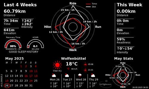

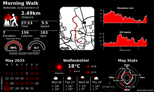

Step 5: Dashboard Layouts & Modes
The dashboard currently adapts its layout based on the type of day — active or recovery — and presents a variety of key training and environmental metrics in a clean, low-distraction format.
Each layout is rendered in either light or dark mode, depending on your visual preference.
Here’s what’s already implemented:
Daily Logic: Two Main Layout Modes
  1. Active Day: shows your most recent activity, core metrics, and weather for the upcoming days.
  2. Recovery Day: focuses on training load evolution and a broader overview of trends and progress.
Current Dashboard Elements
Monthly calendar
  1. Displays the current month with active days marked in red, offering an immediate visual overview of your activity streaks or gaps.
Radar chart
  1. A circular diagram compares time and distance across the last 4 weeks and the current month, helping identify focus areas or imbalance between activity types.
Recovery metrics
  1. Includes recovery time and chronic load from high-intensity sessions, giving a clearer view of how strained (or fresh) your body might be.
Weekly intensity stats
  1. Displays the current week's accumulated low- and high-intensity minutes, based on data pulled from Strava/Garmin.
Weather forecast
  1. A dedicated section shows the next four days of weather for the location set in the configuration file — including icons for clarity.
Each element has been designed with readability on e-paper in mind, using black/white/red only, and keeping typography and layout minimal.
  1. More layouts and additional visualizations are on the roadmap (see Step 6!), but even in its current state, the dashboard gives a rich and actionable overview of your training journey.
