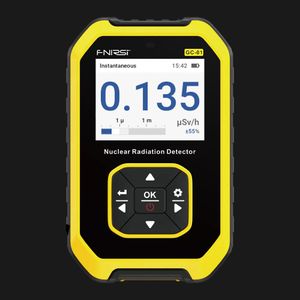

Introduction: Custom Firmware for the FNIRSI GC-01 Geiger Counter
The FNIRSI GC-01 is currently among the best-selling Geiger counters of amazon.com, but its original firmware lacks many features, in particular pulse clicks and data logging!
So I decided to port Rad Pro, a custom firmware for Geiger counters I did last year, to the FNIRSI GC-01.
In this instructable I will teach you how to install Rad Pro on your FNIRSI GC-01.
With Rad Pro, your FNIRSI GC-01 will be able to:
  • Measure instantaneous radiation rate.
  • Measure average radiation rate for performing surveys.
  • Measure cumulative dose.
  • Set up user-adjustable rate and dose alarms.
  • Plot radiation rate history (10 minutes, 1 hour and 24 hours).
  • Log data to the built-in flash memory or live on a computer, optionally sending the data to the gmcmap.com, radmon.org and safecast.org radiation monitoring websites.
  • Generate true random data: secure passwords (alphanumeric, full ASCII), random hexadecimal and decimal numbers, dice throws (4-sided, 6-sided, 8-sided, 12-sided and 20-sided) and coin flips.

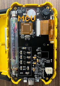

Step 1: Open the Device
Follow these steps to start installing Rad Pro:
  • Turn off the device.
  • Remove the screws holding the back case and open the device.
  • Disconnect the large battery.
  • Take note of the MCU (microprocessor) installed in your device: CH32F103R8T6 (WCH) or APM32F103RBT6 (Geehy). The picture above should help you identify the MCU. WARNING: Rad Pro does not work on devices with a CACHIP microprocessor.
  • Take note of the type of Geiger tube: the markings on the glass should be either J321 (as in the picture above), J305, M4011 or J614. If you have an unmarked tube measuring 55 or 65 mm long, you probably have a J614 or J613 tube, respectively.
  • Also, take note of the type of LCD display: the marking on the ribbon cable should be “CL24CG1045-40B”, “ENH-TV0240b026” or “GMT024-05 V2.0”. If it does not match any of these, please create an issue.
  • Close the device.

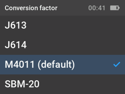

Step 3: Configure Your Device
Go to Rad Pro's settings, select “Geiger tube”, “Conversion factor”, and select the option that matches the Geiger-Müller tube installed in your device.
Within the “Geiger tube” settings, select “HV Profile” and choose an appropriate HV profile: “Energy-saving” is best for measuring background levels of radiation; “Factory default” is the profile from the original firmware and consumes considerably more power.
If the “Energy-saving” does not produce any tube counts, you will need to setup a custom HV profile to reduce power consumption.
If your device produces spontaneous key presses by itself, select the “Energy-saving” HV profile or use a custom HV profile to fix this problem.
