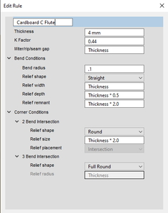

Cardboard Flute C Sheet Metal Rules in Autodesk Fusion
