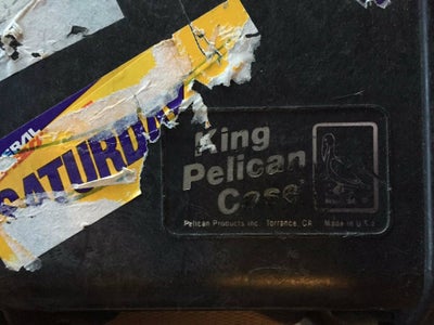

Any type of case, piece of luggage, or enclosure will work. you have to make sure it is deep enough to fit all your components. For this build I found a very used and abused Pelican King Case (now called the 1600). The case I was able to acquire was fairly banged up, and missing a clip. I wasn't worried and contacted Pelican to see if I could buy a new seal and clip for the side. Their response was NO. I couldn't buy the parts because they were free since Pelican offers a lifetime warranty. Very lucky on my part. They did mention the case had to be at least 10-15 years old since it's marked King Case, but who cares right?
You could even check your local thrift shop for hard side luggage or even craigslist for free cases. sometimes they're out there and Pelicans come with that awesome warranty.

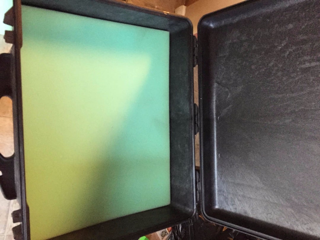

You can purchase many types of foam inserts for cases or make your own. Many folks will direct you to Kaizen Foam or the pluck and pull commonly found in Pelican cases. I chose to save some money and hit the local stores. At Joann Fabrics I found a green foam used in upholstery. The nice thing about this material is it comes in various thicknesses and lengths. Joann Fabrics had it on sale for 40% with an additional 20% for signing up for their text coupons.

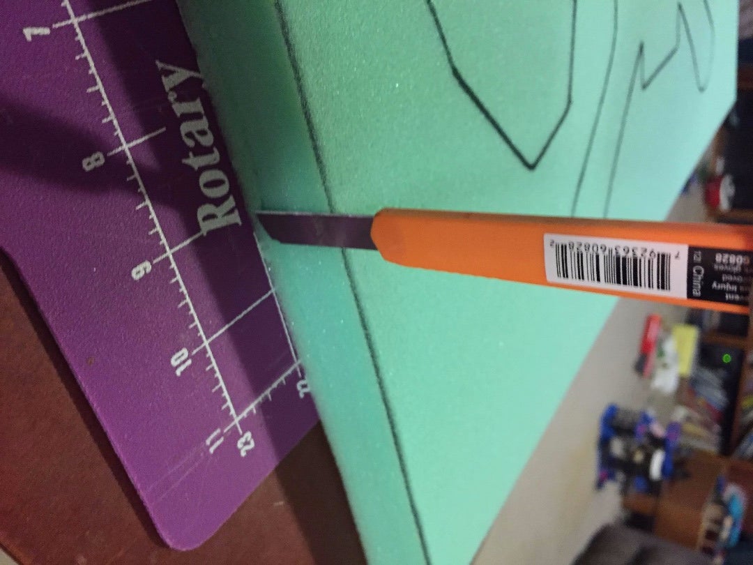

I removed the bottom foam from inside the case and used it as a template. Since the foam edges are nice and straight I lined it up on two edges and then marked it with a Sharpie. Once it's marked, a nice sharp knife and a good straight edge will get you where you need to be without measuring. Cut as many layers as you need to fill the case keeping in mind the lid. The layers will allow you to cut out levels in the foam for different depths.
Note: When cutting the foam (if it's soft like this type) don't try to cut completely through on your first pass. Make a few passes each one a little deeper than the other. You'll make it through fairly quickly without distorting the cut because you pushed too hard and squished the foam. Also try to keep the knife perpendicular (at 90 degrees) to avoid angled cuts unless you want them that way.

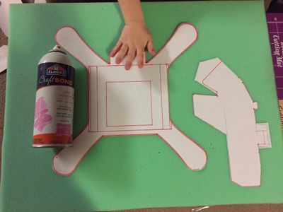

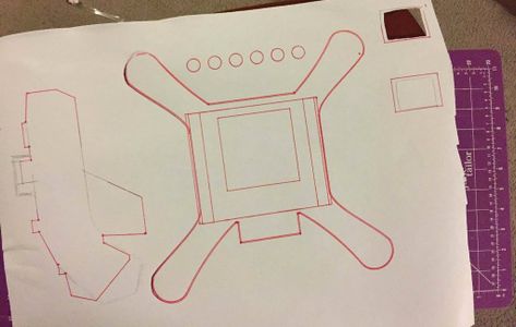

For the next step you will need some templates. This can be done a few different ways. You can measure each component and make notes for a drawing later, or find a way to trace the items your going to place inside your case. For this project I tried both to see which was better.
Note: For the controller and other items I recommend simply tracing around them. This goes much faster and due to the odd shapes it's much easier. For things which will fit into a box or rectangle just using the measurements can work as well.

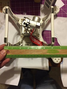

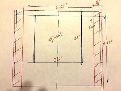

For the aircraft itself, I wanted to provide support and protection beneath the gimbal and camera system. For this I drew out and measured the footprint of the Phantom. I then determined where the camera would land within that footprint and made a box for it.
Note: The landing skids don't need much room, but leave a little extra space to make removal easier.

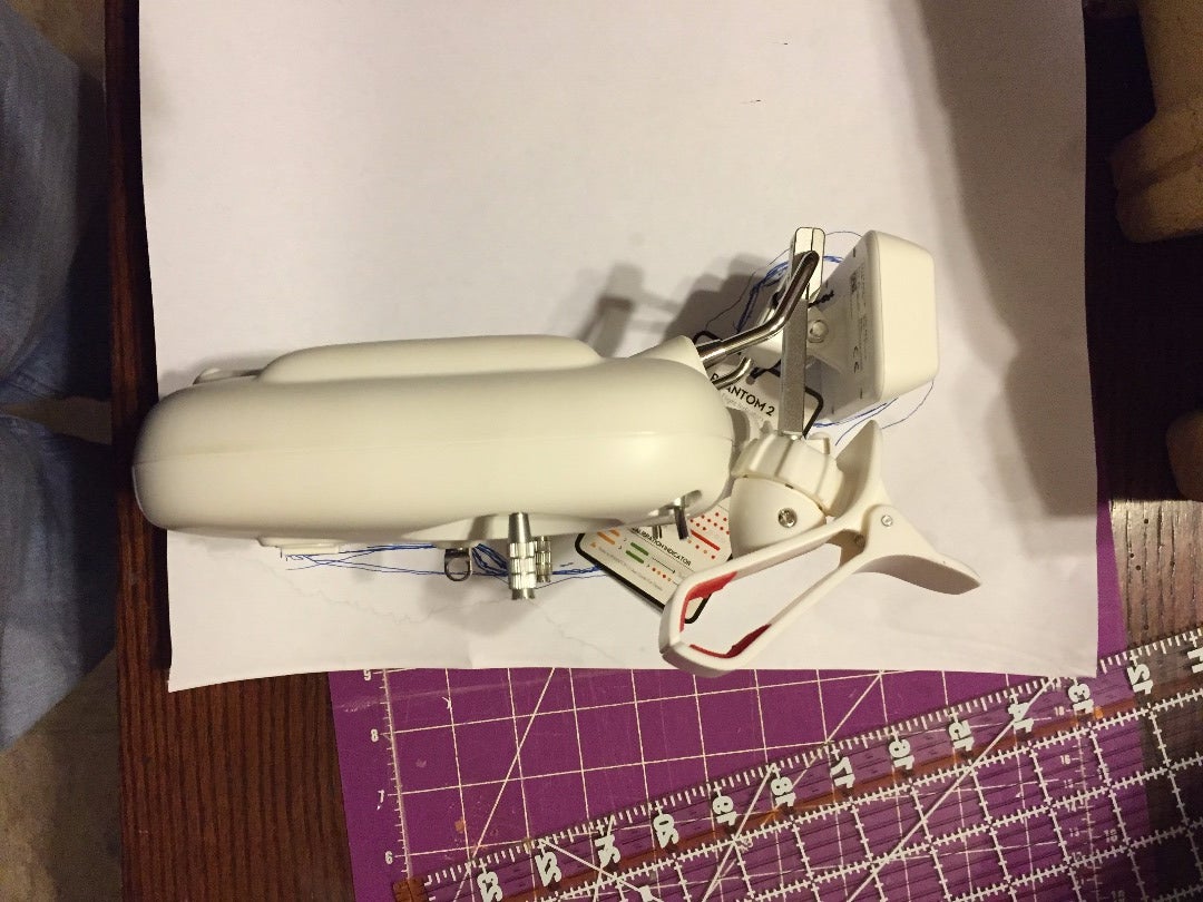

For the copter itself I removed the propellers and turned it upside down. I then traced around the shape and included an area in the event I want a have a battery installed while it's in the case. You can now begin deciding where items will be inside the case.
Note: Initially I drew out the entire template and later decided to use a cutout method. The first plan was to cut through the paper, but it was harder than I thought to keep a straight line.

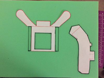

Cut out the templates you drew for the items to be stored and begin laying them out where you want them. I used repositionable Elmers spray glue to lay out the templates onto the foam. With the templates stuck down so they don't move on you, trace them with the Sharpie.
Note: Remember you are tracing OUTSIDE the template. If you want a more snug fit, cut inside the lines
