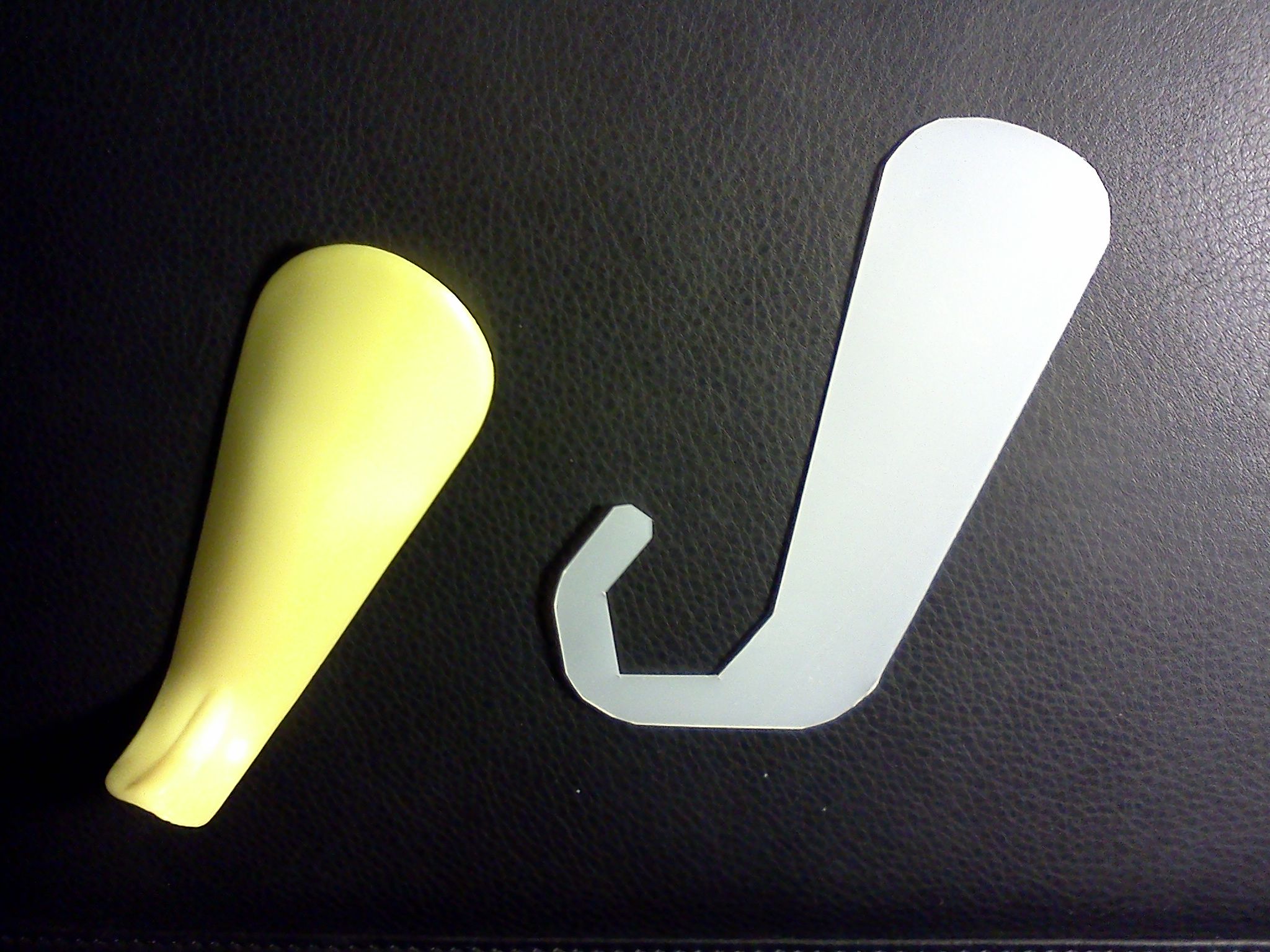

Step 8: Sculpt the Temple.
Get the flexible wire and curve it around your ear.
There should be two bends
1. Around the ear
2. Around the head
