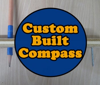

Introduction: Custom Geometric Compass
Have you ever had the problem where the tool you were working with just did not measure up?
For the first time ever, I found my tool just did not have enough reach. I needed just an extra 1/2 inch. Sure, I could go out and buy another tool with more reach, or I could Build It!
In this Instructable I will show how to Build a Tool. a custom geometric compass in order to draw a 10 diameter circle.
All you need is a piece of scrap wood or plastic that you have pulled from the trash, masking tape, and wood screw. Oh, and a few tools for building. Once complete, this will be another treasured tool for your making needs.

Step 6: Prepare Pencil
Upon fitting the pencil through the pencil hole I discovered it was not snug as needed. The pencil should not move easily through the hole as we want the wood to grab and hold the pencil. So I added one layer of painters tape around the pencil. The pencil now fits as snug as a bug in a rug.
Step 7: Drive Screw Through Wood
The 1 3/4 inch wood screw is going to be the "needle" or fixed point of the compass. Drive the screw through the wood. Be sure to drive it straight. Slow and easy!
Step 8: Insert Pencil
Insert pencil into the 5/16 inch hole.
Your tool is complete! Now go draw a circle.
