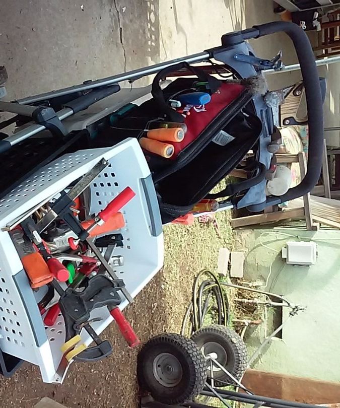

If you don't have a drill, most of the parts were made of soft plastic so you could simply cut them open with a razor knife to start a hole then widen the hole with scissors. The tools used here were a cordless drill, hot glue gun, scissors, sharp drill bits, gloves, razor knife, marker, and wire-cutters (to cut off excess from the zip ties).
