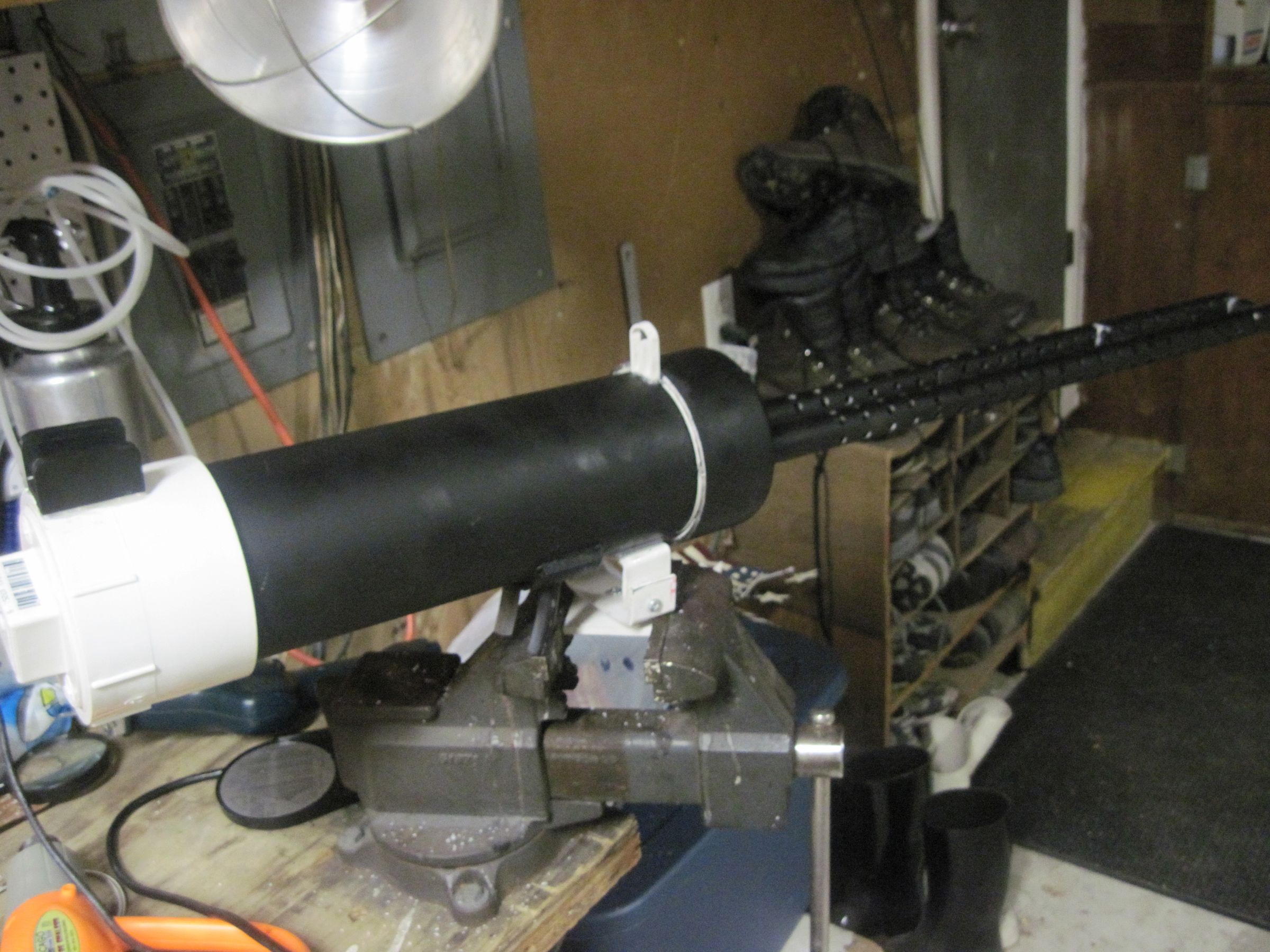

To mount the sights, you will need the sights you just made, some gorilla glue, and the weapon you will mount the sights on. Choose the spots on which to mount the front and rear sights. Mark them. Glue the front sight where you made the mark. Glue the rear sight where you made the other mark. Try to line it up with the front one. If you want to, paint the sights. Use contrasting colors such as black on the back sight and white on the front to make aiming easier.
Step 7: Optional Step: Making the Sights Really Effective
If you can get or make a laser boresighter for the wepon these sights are on, then place it in the barrel and turn it on. Aim at something ~20 feet away (6.09M for those on the metric system) Now try to heat the bottom of the front sight GENTLY and bend it a little. Now look down the sights and see if they line up with the laser dot yet. Adjust until they do. You may have to adjust the rear sight as well to keep it in line with the front sight. Congratulations! You have just made fully functional custom iron sights for your weapon!
