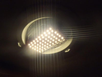

Introduction: Custom LED Touch Light Fixture
My wife and I really didn't care for the light fixtures that came in out fifth wheel camper, so we decided to replace them with a pair of cheap, matching fixtures we found on clearance. Since the camper lights run on 12V DC, I knew I would have to rip out the 120V AC sockets and replace them with 12V DC ones as well as as some sort of switch. Of course, I ended up over-complicate things, and after one thing lead to another, I ended up designing and building a set of LED fixtures with multiple brightness modes that operated by a simple touch of the fixture.
LEDs are much more efficient than the bulbs in use and will probably never have to be replaced. The decision to make the fixture touch sensitive came from my difficulty in finding a suitable push on-off button in white that can handle larger amounts of current.
Although my design is based on a 12V DC power source, a similar project could be made by using a regulation circuit to convert the AC power in your home to a suitable DC level. Remember, any time you are working with electricity it is VERY important to turn off the power source before you try to connect anything. NEVER work with live voltage lines!

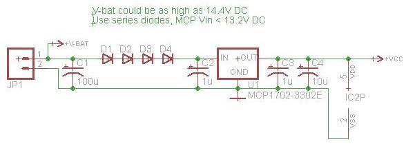

Step 3: Schematic Overview 1 - Power Supply
This circuit is designed to run on 12V DC, but it could really be sourced by anything (including AC mains) as long as proper regulation is used. I chose a logic voltage of 3.3V instead of the more widely used level of 5V because the components will consume less power. The MCP1702 regulator comes in a 3.3V package, but can only accept inputs up to 13.2V. However, a 12V battery charger will actually reach a level of around 14.4V DC, and for this reason, I placed 4 series diodes before the regulator to ensure the input voltage does not exceed this level. The first capacitor, C1, is to help supply the LEDs with immediate power when they are turned on. The surrounding capacitors are needed for proper regulator output and voltage stabilization. If this circuit were to be used in a typical house using an AC voltage, a transformer and rectifier circuit would need to be used to create a suitable DC level for the LEDs as well as an acceptable input level for the shown 3.3V regulator.

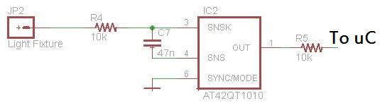

Step 4: Schematic Overview 2 - Touch Sensor
This is really the central component of the entire circuit. I used a single channel touch sensor chip from Atmel - the AT42Qt1010. The only bad thing about this chip is that it didn't come in a through hole part, so I had the joy of soldering a tiny surface mount component to the perf board... but more on that later. The sensor really works through capacitance, and it is important to get a proper value for C7. Without being connected to the fixture, the LEDs would randomly turn on and off just by walking by the circuit, but this high of a capacitance was necessary for the large fixture to be sensitive enough to work. A different sized light fixture may require a different sized capacitor. The two shown resistors are only there so the sensor is not directly connected to the fixture or two the microcontroller.

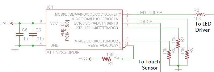

Step 5: Schematic Overview 3 - Microcontroller
The Atmel AVR ATtiny25 is the heart of this circuit, although any similar uC could be used. It has two jobs: 1) Wait for input from the touch sensor and 2) Send an appropriate pulse to the LED driver. The only other thing this uC should do is conserve power, so it waits in a sleep mode which can only be interrupted by a pulse from the touch sensor. The bypass capacitors C5 and C6 are not entirely necessary, but at least one of them should be used. The resistors R6, R7, and R8 are used to safely connect the unused pins to ground. Floating pins are never a good idea, and directly connecting a pin to ground or a voltage can be dangerous if a pin goes into the opposite state for whatever reason.
The LED driver is connected to a dedicated hardware timer output, so it's operation is independent of the main processor, but I'll talk more about that in the Step 8 - Source Code.

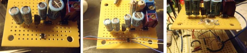

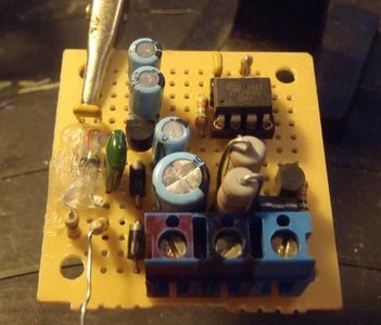

Step 7: Building the Circuit
I always try to use through hole parts when working with a perf board, but they aren't always available. In this case, the touch sensor only came in small SOT23-6 package. I was able to glue the part to the board and solder small wired directly to the pin leads. I then covered the chip in hot glue to prevent the wires from getting yanked off.
The rest of the build was pretty straight forward as long as you know how to solder. The most important thing to remember is that the wires going to and from the LEDs need to be bigger gauge because of the larger current flow. Another important aspect is heat regulation. The MOSFET transistor will get hot sinking this current, even though it is rate for a much larger one. This component cannot be up against other things because it will need plenty of airflow and potentially a heat sink for proper operation. I learned the hard way and had to replace it twice before decided to house that particular component outside of the fixture, but more on that in Step 10 - Completing the Fixture.

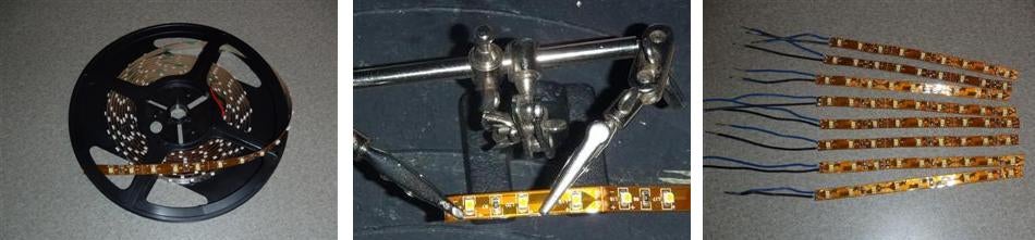

Step 9: Preparing the LEDs
I picked up this roll of LEDs from Amazon. The main thing to consider when purchasing these LEDs is the color. White LEDs can be a point of confusion for some. There are actually cool white LEDs and warm white LEDs. The cools have more of a blue shade and will alter the way things normally appear under light bulbs. This can lead to disappointment if you are not anticipating this change. Warm white LEDs more closely resemble the yellowish light emitted from a standard light bulb or the sun.
The roll of LED strip lights I got was great, but came ready to be used meaning each string of LEDs already had a series resistor. The roll is basically a bunch of 3 LED strings in parallel, so it can be broken up every 3 LEDs. The series resistor in each string needs to be shorted or the current source LED driver won't work correctly. Wait, am I suggesting you alter (or ruin, as my wife would say) a perfectly good roll of LEDs? Why yes, yes I am.
I used 24 strings to provide enough brightness, but your necessary amount of LED strings may increase or decrease. If so, be sure to adjust the value of R3 in Step 6 accordingly to provide the correct amount of current through each string.
I recycled the leads of components I cut off when building the circuit and used small pieces of solid wire when I ran out of cut leads. The traces on the LED strip can be soldered to directly. When that is done, each LED string needs to have a pair of lead wires so they can all be connected in parallel.

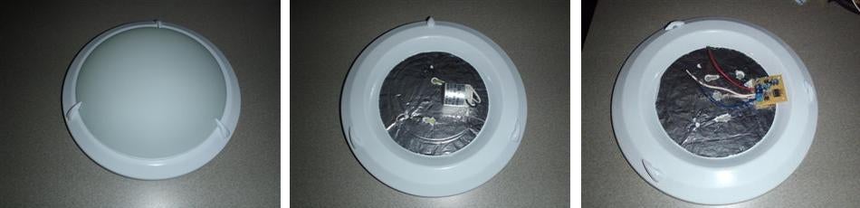

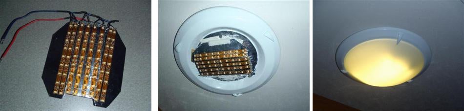

Step 10: Completing the Fixture
Now comes the fun part - putting it all together! To start, we need to take out all of the socket pieces that come in the fixture. The circuit can then be attached. I was able to bolt mine through the hole left by the original socket, but you may need to drill a hole for this purpose. The lead connecting to the touch sensor was wrapped around a small washer on the bolt, connecting the sensor to the conductive core of light fixture. Although the outer coating is not conductive, the sensor is sensitive enough to work through it because it senses the change in capacitance with respect to ground as a finger approaches. In fact, it will work without a complete physical touch, a finger (or nose, if you're in the mood) just needs to come very close to the fixture.
At this point, the fixture can be mounted in the ceiling. I am assuming there is already a hole with the power leads available. The power can then be connected to the circuit with wire caps.
The next step is to create a housing for the LEDs. I used a piece of sturdy cardboard and bent to wings to force some of the light down at an angle, and lower the LEDs from the circuit. The cardboard was wrapped in alluminum foil to aid in the LED head dissipation and to make it look nicer. Once the wires have all been connected and capped, the LED housing can be attached to the fixture using a few strips of Velcro. This allows it to be easily removed for access to the circuit or to remove the fixture.

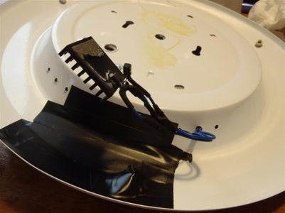

Step 11: Heat Considerations
As noted in Step 7, the heat dissipation of the MOSFET is very important. I burned up two of these parts before I really solved the problem. Because the LEDs are enclosed in the glass fixture covering, the fixture interior air quickly heats up when the LEDs are on. Since the MOSFET is also hot from sinking a large current, it needs proper airflow to cool off, but it cannot if it is surrounded by other components.
The first time the MOSFET quit, the LEDs flashed a few times, and then remained in a dim state. The fixture was unresponsive, so I took it apart to work on it. I ended up running wire leads to the circuit and attaching a new MOSFET to these leads hoping that the part would get enough air flow raised off of the circuit. But after a few days of running, it too gave up.
This time, I decided to run the MOSFET leads through a small hole I drilled outside of the fixture. The part would still be concealed by the fixture outer rim, but it would be outside of the hot air filled interior and stood a chance of keeping cool. I also affixed it to a large heat sink. This solution has been very effective. The entire fixture has worked flawlessly with this heat dissipation in mind. I also covered the surrounding fixture area with electric tape to prevent the heat sink from touching the fixture and effecting the sensor sensitivity.
